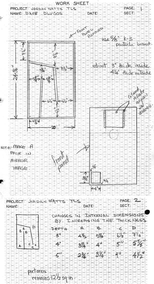

Long before the internet I remember sitting reading that brochure.
We mounted our Jordan-Watts into a wall mounted TL.
