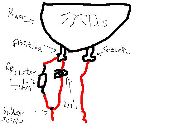

2. To extend the bass a little on the JX92S you may want to put a resistor and inductor in series with the driver. R=4.0 ohms, L=2mH.
3. A little silicon sealant might come in handy. You'll want to make sure all the joints are sealed and also around the port tube and the input cup. A dab on your solder points doesn't hurt either.

what does "in series" mean? Does the resistor and inductor REALLY help?
That little bit of wisdom is not mine, it comes from the EJ Jordan website here.
When I've done this I've soldered the leads of the R and L in parallel and put that combo in the middle of the wire going to the positive pole of the driver. It looks like a BDSC network. There's a example of it here. Look on page 4.
So it should look something like this (?):
(I am quite the artist :D)

yep, that's it. You can "glue" the R and L together with some silicon sealant, attach it to a small board (almost anything will do as long as it's not metal) and mount it somewhere inside the cabinet. Probably easiest to put it on the rear panel next to the input terminals.
