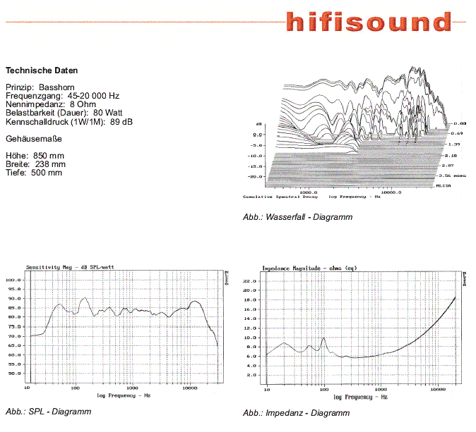

Anyone looked at the Jordan JX92S horn design by Bernd Timmermans? Here is the webpage for it at Hifisound:
http://www.hifisound.de/bausatz/jordan/horn.html

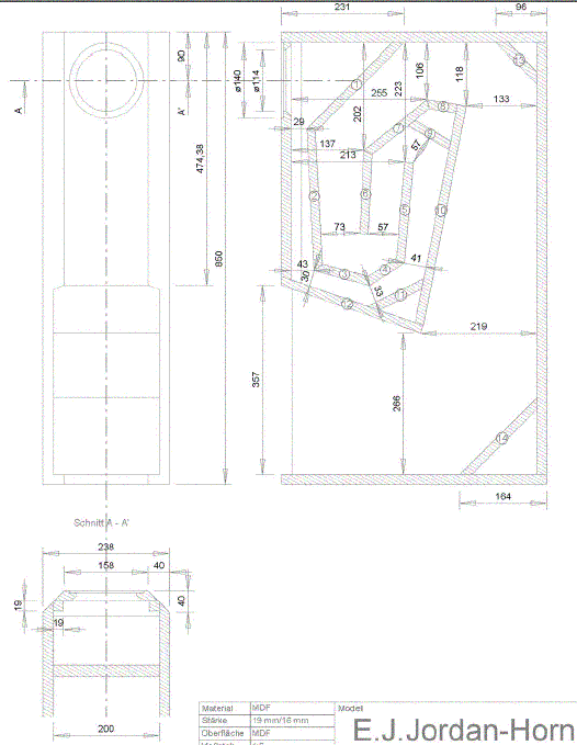

pdf with dimensions:
http://www.hifisound.de/bausatz/jordan/horn/info.pdf
It looks interesting. Are there any other horn designs for the Jordan JX92S?

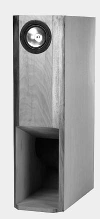

Nielsio said:I have a plan of making a fronthorned JX92S for friends of mine in the future.
Do you have any pictures of the plans? I am curious as to what it would look like. Here is the plan for this horn:
Brian
Tractrix fronthorn. Cutoff 200 hz -> ~55 cm diameter & ~ 22 cm deep.
Crossed 1st order (200 hz) to:
1. Supravox 285 GMF; open-baffle or bass-reflex
or
2. Scan-speak 21W/8554-00; sealed or bass-reflex
Option 1. and 2.-sealed leaves room for a subwoofer:
- Scan-speak 25W/8565-01; bass-reflex -> ~24 hz -3 db in 135 liter enclosure.
All drivers with their own gainclone-style amp. Jordan runs full range (or maybe with a small cap); bass and sub have active filter.
How about that?
PS Making a tractrix fronthorn is very hard. I have an idea about a cost-effective and quite easy to do method, but untill I experiment more, I'm silent about it.
