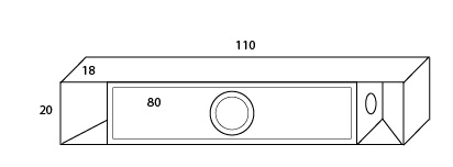

Hi, I've have 2 jordans in VTL transmission line (Essence clones). I'm planning now to make 2 surrounds and a center. The surrounds will be Jim Griffin's minimonitors like http://www.briangt.com/gallery/jx92s .
But for the center channel I'm thinking about an enclosure like this http://www.diyaudio.com/forums/showthread.php?s=&threadid=38755&highlight=jordan+jx92s but with the drive in the center of the box like the attachment, with two ports. Is it clear?
What do you think? Is that possible? I have no idea of speaker design 🙁
That's because I think that central channel deserves a "bigger" or more complete sound that surrounds, and I like that shape to be used under my screen.

If you have enough room, and some distance behind your seat, the surrounds would probably deserve to be the same as mains. This way you may not even need the subs since you have atleast 4 speakers that go down to probably 40Hz.
Go for the lowest XO point for the sub, depending on your room size, Get a sub that can push preferably more air than 5 Jordans as calculated by the cone area x xmax (make sure that if its Xmax p-p, then use the same for all, some express it one way only).
If you use a separate active sub (such as the one sold at the Jordan site) it would be good to have some phase adjustment to experiment for best effects.
