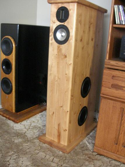

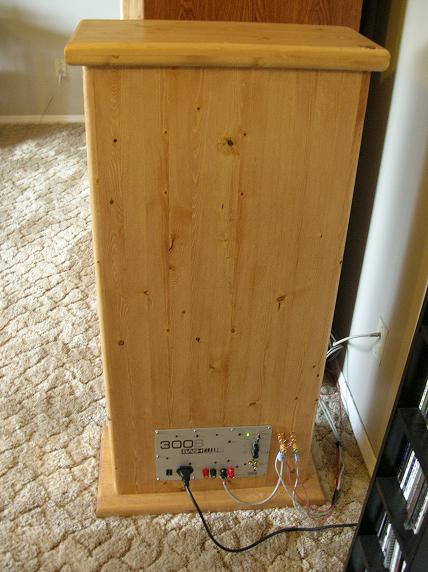

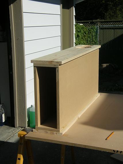

I thought it might be interesting to show a set of speakers that I built using the Jordan Mini Monitor as a top end of a large floor standing speaker. The monitor is built right into the speaker and the bottom 2/3rds of the floor stander is utilized as a sub woofer. The speakers that I used were the two mini monitor drivers as noted in the subject line and the cross over is made for this mini monitor as indicated in Jim Griffith's design. The speaker itself is 42" tall, width is 8 1/2" and the length (depth) is 19 1/2". (outside measurement) The speakers are built with 3/4" MDF then clad with 3/4" pine. The sub woofers are 2 - Axtremis 6.8's powered by 300 watt Bash Amt with 2 - 2" vents x 8" long.

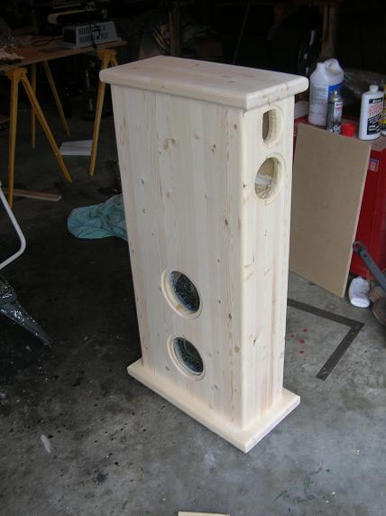

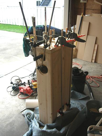

This is the start of placing the pine over the MDF

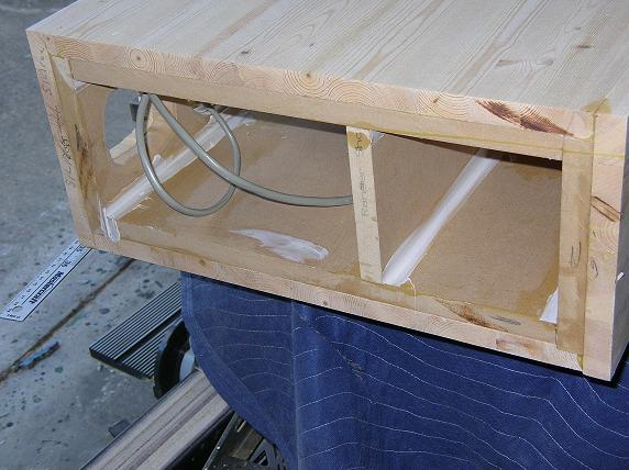

This is the top end of the speaker before finishing. Note: the mini monitor length of approx. 12" is separated by 8" of rear space which will be filled with sand before I placed the top on the speaker.

This is the speaker finished. It weighed in well over 100 lbs. It took two of us to carry it in the house! The speakers after about two weeks break in, sound absolutely wonderful with the bass that I always longed for. My surrounds for these speakers are Jordan Transmission line 13 liter. I also have an 88 liter sub woofer with two Axtremis 6.8 and an Apex amp which I use for anything below 40 hertz. Now I finally have my dream surround sound. Now I just need a good 60" plasma monitor to do justice to these speakers.

There is no port for the top end. The bass ports ,2, are on the back

I noticed your not-necessarily-so-orthodox construction of MDF and solid wood. The wood can in principal shrink several percentages when the air dries, whereas the MDF stays pretty much the same regardless the moisture level in your room. What is the clue you have used to in attaching the MDF and solid wood together? The shearing tension in the construction can become quite significant.
The reason why I am curious about this is that I would love to use similar kind of construction. The real wood gives unique real wood feeling and appearance, which cannot be reached with veneering. On the other hand, MDF is good material for the cabinet, and even if the wood would crack, the cabinet would remain air tight.
Have you noticed any cracks on the wooden surface?
hep
Hep
Your right I didn't even think of shrinkage .The fact that the pine is glued in 2 inch sections at the factory may prevent this. Also the sides were clamped with a little extra width against the front and rear panels, making for a very tight fit. They have been in my house for 3 weeks near a woodburning stove ,so far no cracks.

good to hear that you have not experienced any unpleasant surprises. Being close to stove/oven is definitely a harsh environment for the cabins. Wood burning stove is less damaging, since it maintains the healthy level of moisture; electric heaters dry the air quite efficiently.
Gluing the wood from sections does not prevent the shrinkage (or swelling for that matter) and the tension it brings about. However, the section-glued wood is probably more uniform and has less internal tension to start with.

One important aspect of this kind of construction is that the speakers are solid as a rock (and heavy). Give them the knuckle test and you will not hear the usual bonk, just a dull thud. I did brace some parts of the speaker, espetially the sub part, but being so thick, heavy bracing is not really needed. I also used rug underlay as sound deadening for the sub part of the speaker and polyfill for the top end. So basically the speaker cabinet is dead quiet; the music is comming from the speakers and vents.
