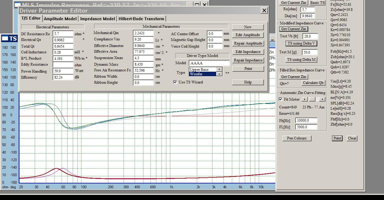

Here are my measured T/S parameters.
DRIVER #1
=praxis= Thiele/Small Parameters
______________________________________________________
Qts = 0.526 Total Q
Qes = 0.712 Electrical Q
Qms = 2.008 Mechanical Q
Fs = 49.751 Hertz, Free Air Resonance
Res = 5.3 Ohms, DC resistance
Ls = 119.6u H, series inductance
Lp = 139.3u H, lossy series inductance
Rp = 989.7m Ohms, loss across Lp
Dia = 100m meters, effective
(%shift) 39.4 %, resonance with mass
Vas = 15.46 litres, air volume equivalent
mms = 5.733 grams, effective mass
cms = 1.785m m/N, compliance
bl = 3.652 T*m, motor strength
n0 = 257.1m %, max efficiency
SplSens = 86.10 dBSPL max @1W absorbed
(Added mass) 10 grams

MJK> Do you remember if those measurements are from a "cold" unit?
R-Carpenter>Pardon me if I'm a litte slow but english is not my native language. To be absoulutely clear, do you mean that the measured data corresponds exactly (or very close to) to the drivers data sheet after they are warmed up?
My reason for asking is this. Years ago I modelled an enclosure and built it based on the TS found in the data sheet. I never finished the speakers due to poor economy. A week ago I decided to finish the project.
I'm worried the box is all wrong because I didn't use measured data, only what the manufacturer posted on his website.
I played music through my new Jordans for a few weeks before doing any measurements, probably 40 to 60 total hours. When I connect drivers to my measurement system I use 10 to 20 averages of the input signal to calculate the driver properties. I probably do this several times before getting the final results. These are all low level voltage/small deflection measurements. So I would characterize my results as being for a driver with some hours on them that have been running immediately prior to measuring at a low input power level.
Any time you use only manufacturer's specs to design an enclosure or speaker system you take some risk. The manufacturer's specs might be very accurate or complete fiction, you won't know in advance.
Sometimes you can find measured driver properties on the Internet in a forum or documented in somebody else's design work. Maybe you could use google to see if anybody has real data on your specific drivers. But that can also be a risk, probably a little less than just using the manufacturer's data sheet.
Correct. Some call it "burn in" but it has to do more with the temperature of the voice coil.
It is of cause best to measure yourself but I think you'll be fine with 92s.
