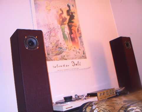

an el-cheapo bipole
hello,
sorry to take the thread down one notch...
i can't afford the jordan's yet, so i built a bipolar transmission line using the RadioShack 40-1354's - great results! the design was done using ML King's excellent TQWT mathcad model (http://www.quarter-wave.com : it really works!)
and the inspiration was from the TL_B speaker project at http://www.t-linespeakers.org
here's one pic. more pix, along with a VERY brief write-up (a longer write-up for www.t-linespeakers.org is in the works) can be found at:
http://web.mit.edu/~sarin/www/tlb.html

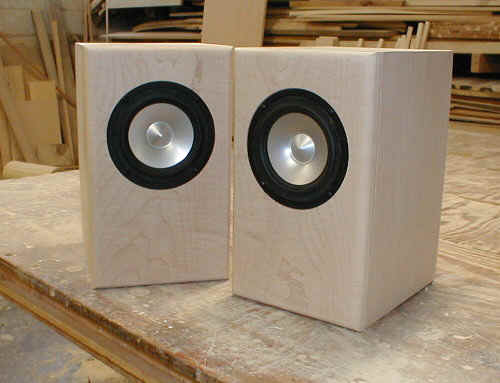

Image is of the cabinets for the ESg2 ribbon. They are 7 inches in depth and have a grove cut in the bottom (top of image) to allow the box to be time-aligned with the Jordan cabinet (next image).
The top box is all spanish cedar, the lower ones are beech and cedar.
