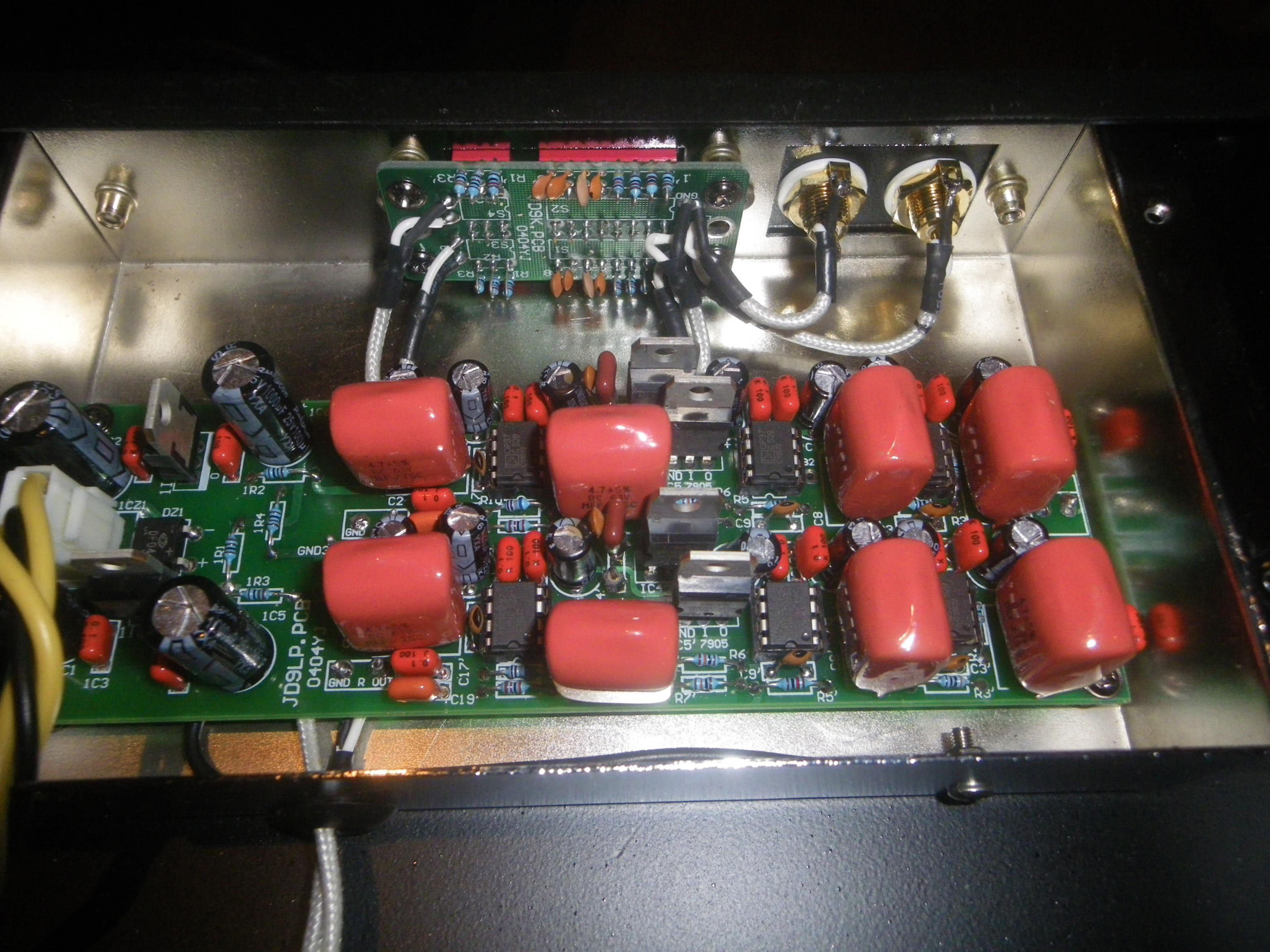

Hiya, hope all's well. I have the op amps (AD843KN) and capacitors (AMPOHM: FP-CA-1-AU) lined up for replacement in my Jolida JD9 phono stage. I've already rolled the tubes to good effect and the op amps are a doddle to change. It's the caps I'm worried about.

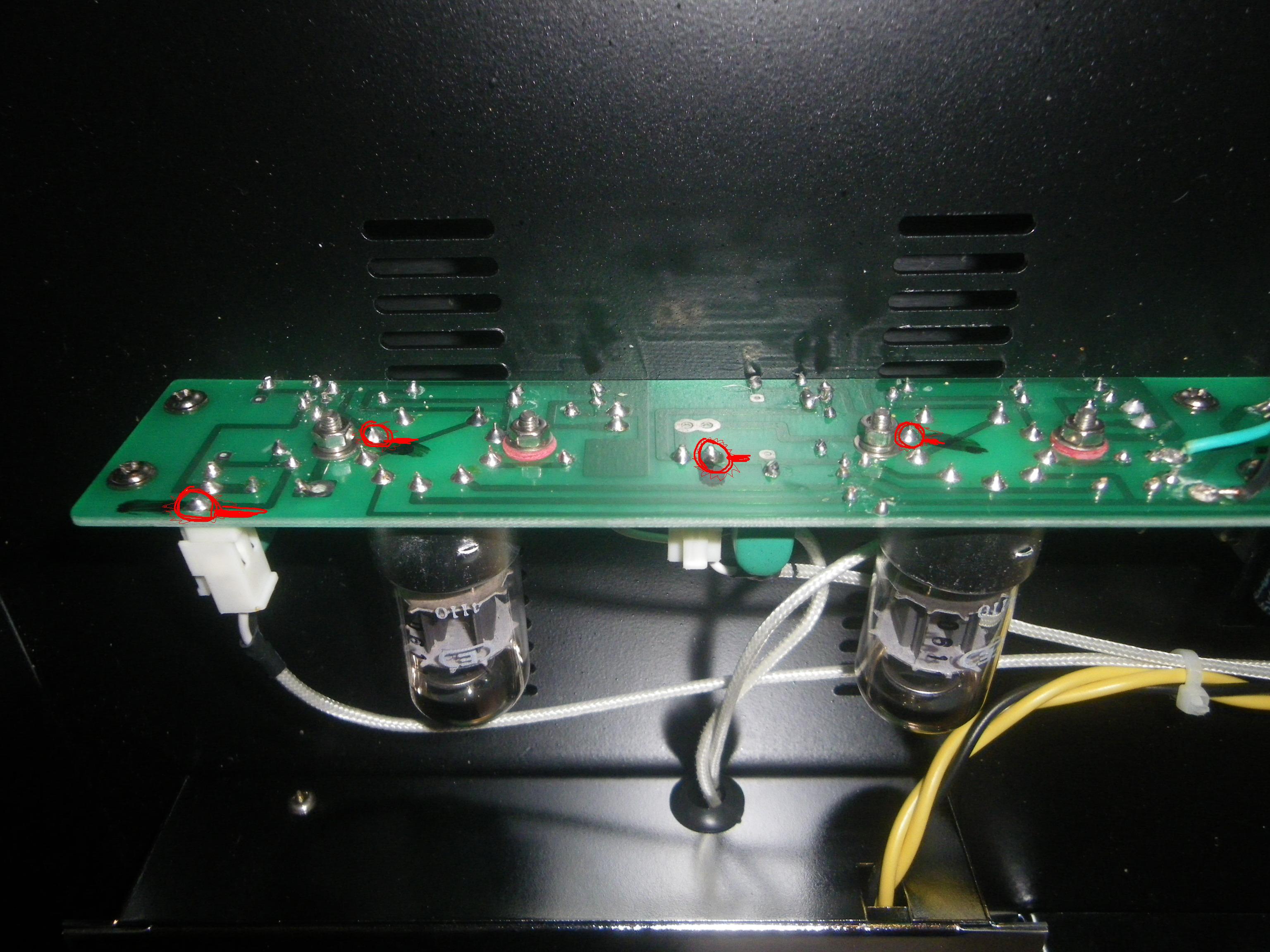

Where is the left hand solder of the left hand cap connected, is it not connected above as it appears different to the pic below?
Trouble is, I can see from the pics where to solder (more or less) and I admit I'm a total newbie but with pictures like these I can get through it no problem. However, the article suggests removal of the "old capacitors", and I could do with someone double confirming which ones these are please.

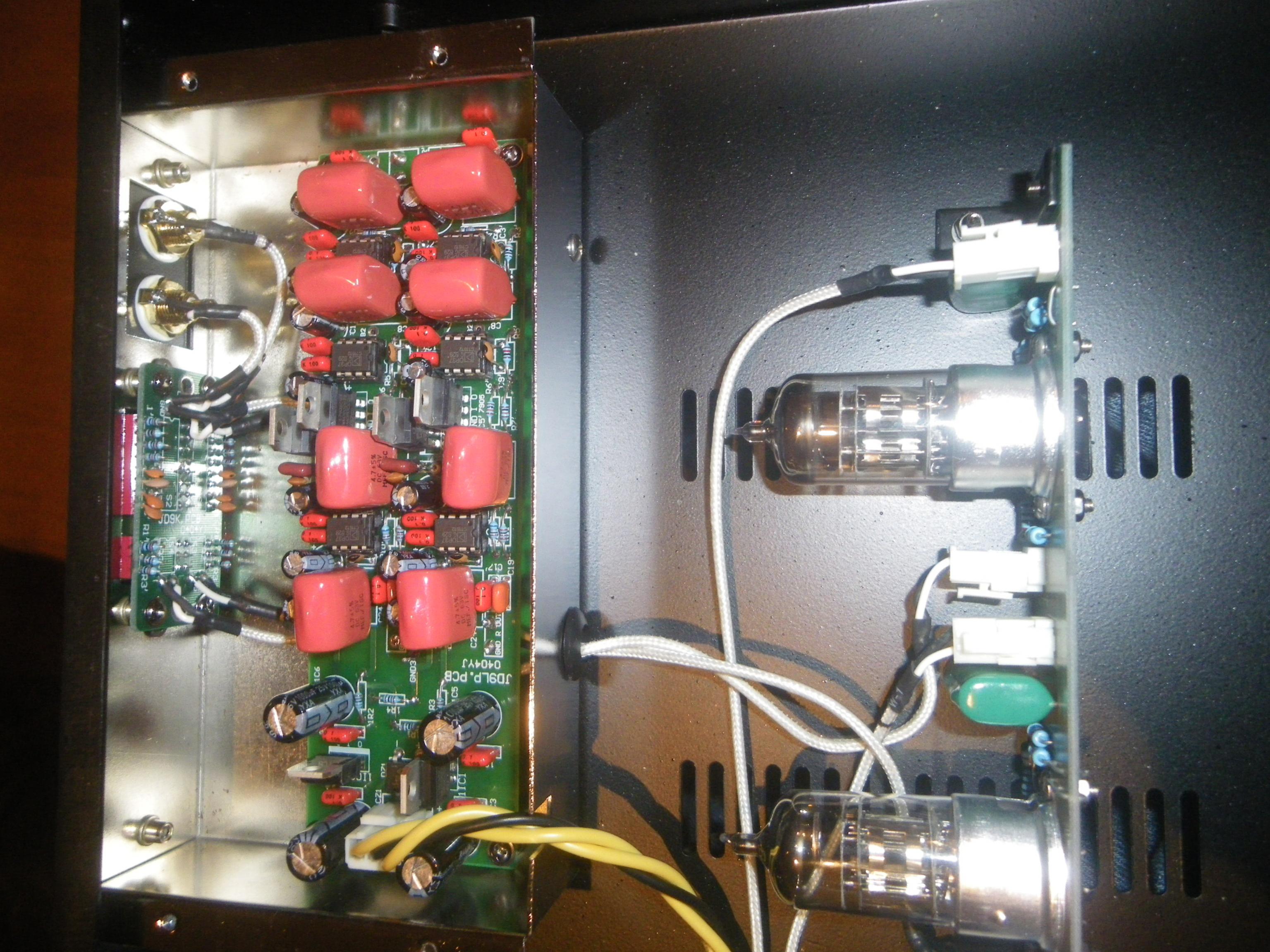

There's a pic of the layout here and you can see the six op amps in the top right too.
Thanks in advance good people. Ultimately I'll then populate this page with many photo's along the way, hopefully bringing together the info from other sites (which isn't complete in any one instance, there's always the need to trawl around).

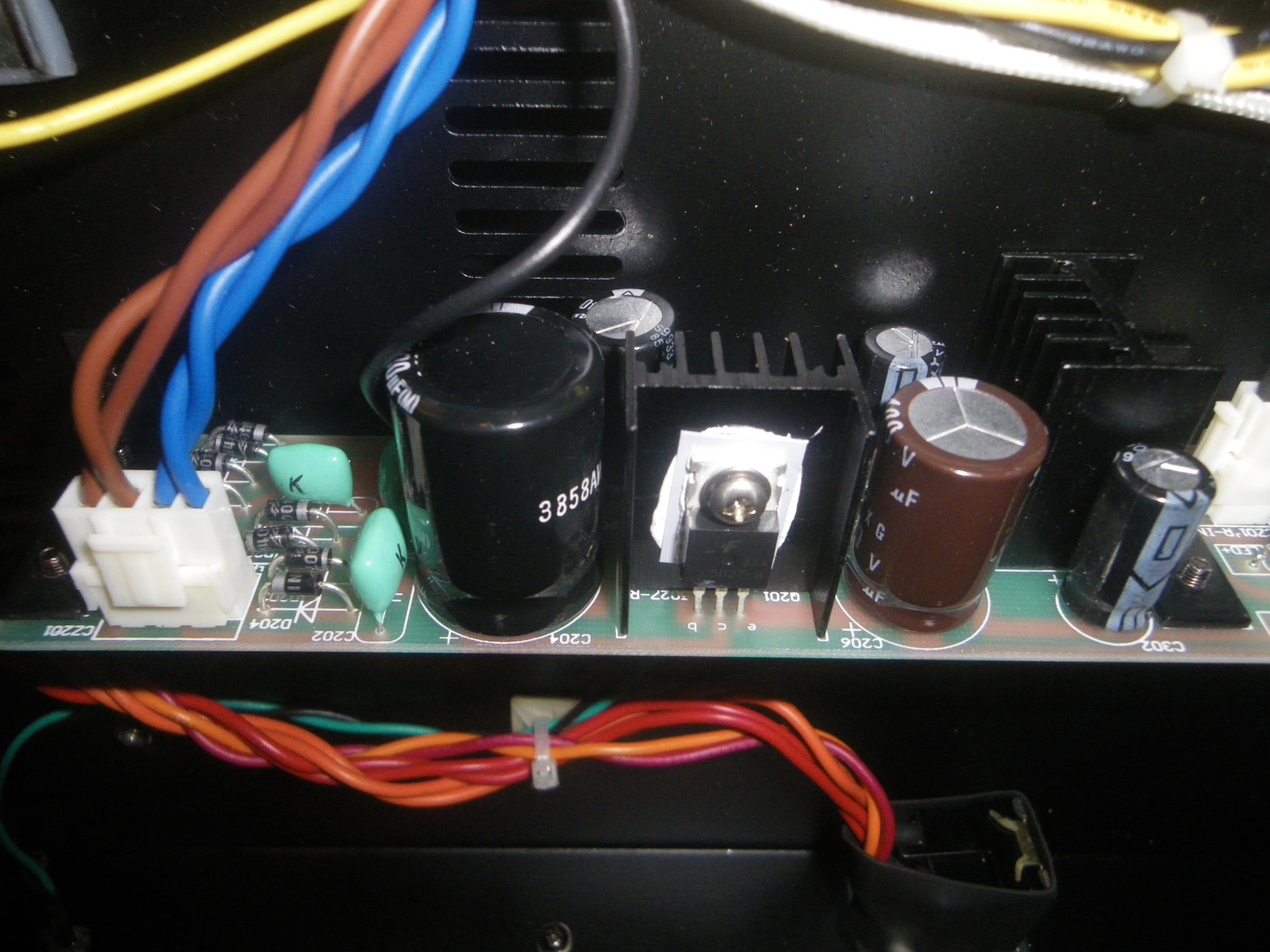

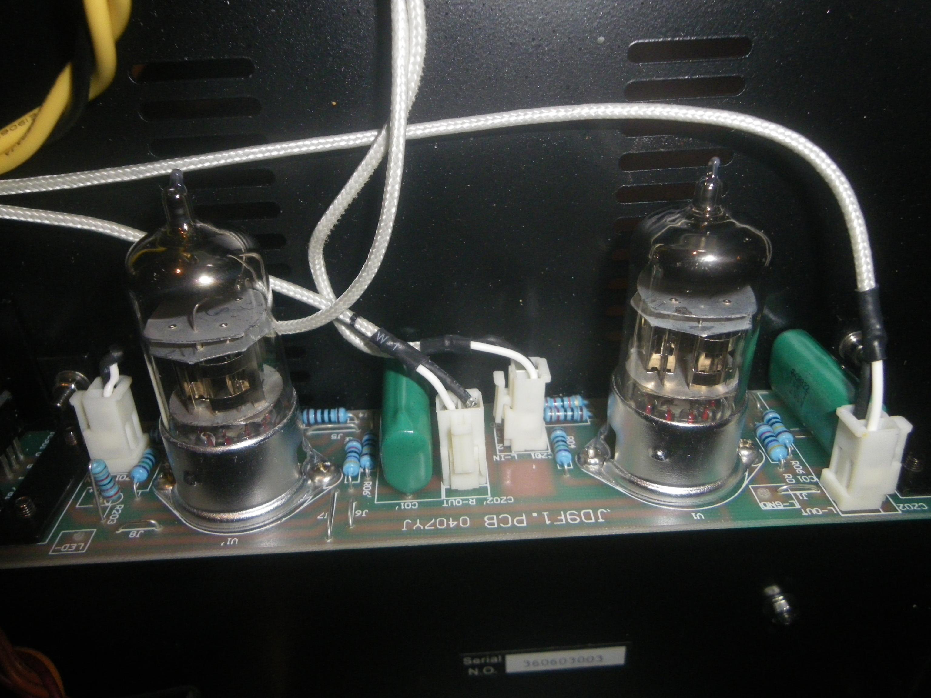

There's a small green capacitor next to each valve (they'd be on the right of the valves as viewed in the photo above), these are doubtless the ones to remove but I thought I'd better confirm.

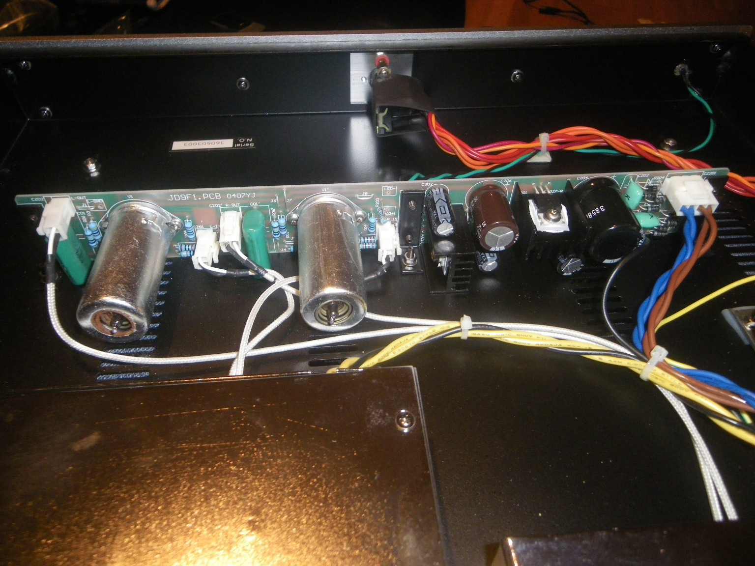

The caps your looking for are the output coupling caps. if you follow the wire from the output rca jacks you will find the proper caps to pull.
Very timely thread as I myself have just purchased and modded a JD9. I went with mundorf supreme 1.0uf for the output caps. I had 2 linear technologies LT1028acn which i put in the input position (the 2 right most in your pic). I added some jantzen crosscap 1.0uf bypass the electrolytics in the power supply.

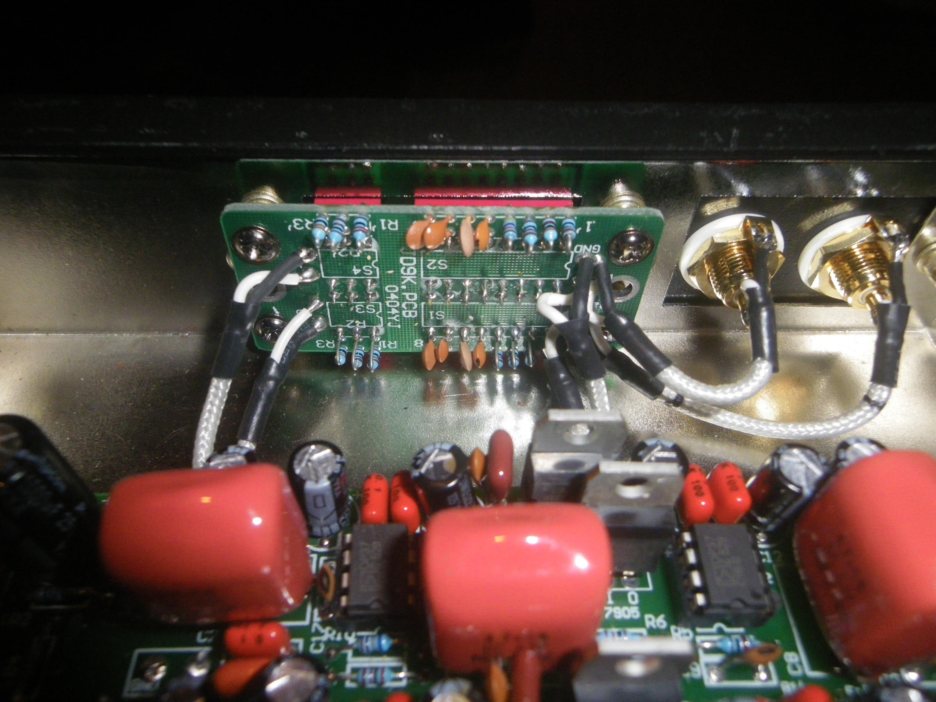

Great stuff, thanks. Here are more pics for other interested parties (this is the unit with the old tubes attached, all prior to modification).
So Photo03 shows the two green caps to remove. Thanks.

The cap change has made a significant improvement to the positives of enjoying the music, but it's also made a slight contribution to the negative. There's now a background "hiss".
It's not too bad but that's as technical as I can get, it's definitely a hiss and not a hum. Is it my lousy soldering or something else?

in the thread over at audiocircle there is talk of not replacing all 6 opamps with AD843KN. could this be your problem? try replacing the original opamps into the output position. ( the ones on the left in your pic above.)
If your going to open it up reflow your solder joints, and make sure the opamps are seated into the sockets securely.
good luck.
True enough. I replaced the old op amps back in the outputs and the hiss reduced a lot, they're right when they say it's not ideal using the AD843KN in all six slots.
