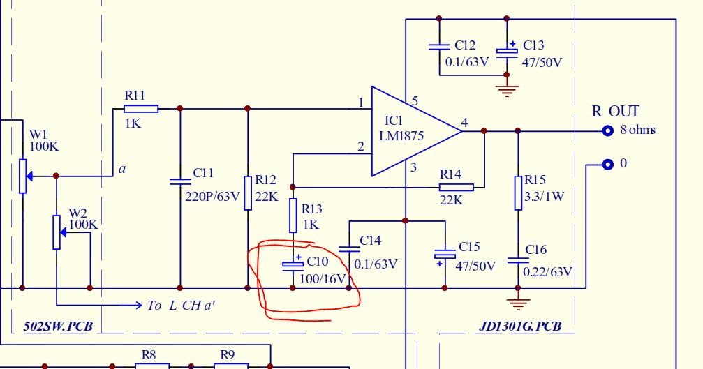

Hello,

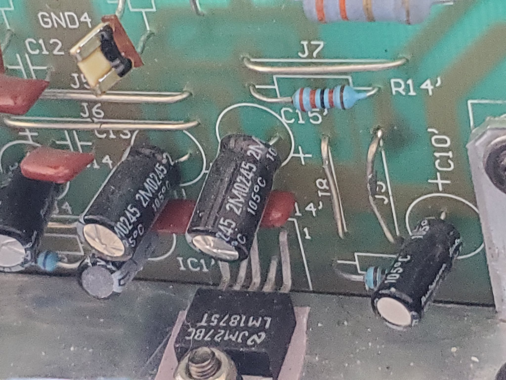

I have a question about my Jolida 1301. The cap C10 (100uf/16v) seems to be reversed on one of the channels. The marking on the PCB itself is reversed and on one channel the positive + side of the cap goes to ground and on the other channel the negative side does. The other side is connected to the R13 (1k) resistor in both cases. What is the correct polarity? Shouldn’t they both be identical, since everything else is perfectly symmetrical?

Thanks. It is going to be hard to measure in such a tiny space. If the image displays properly, you can see the c10 cap with its + side to ground (on the right side). The lowest hanging cap on the left side is its counterpart, with the negative going to ground. I tend to think it s a mistake, but I hear no difference between the channels.
well, I measured. And there is zero V across it!
What now, I am scared 🙂 Should I reverse it? The schematic is clear about c10. The only reversed cap is C15
C15 is reversed because it's connected to a negative voltage rail and ground. C10 actually has AC across it, as it's connected to the amplifier output, which can swing both + and - voltages. So it really doesnt matter which way it's installed. Lousy place they put it, for servicing; had to take the whole amp apart to put it back, after replacing with a wire, before I sold mine.
I'd recommend replacing it with a better 10 uF cap. Or just shorting it with a wire; that's easy to take off if the sale day ever comes.
🙂 I don t know why that made me chuckle, maybe the relief of knowing i ll be fine either way. I ll surely replace it with nothing, as i am building two monoblocks from scratch based on the circuit. I hope that 100uf cap isn t an important safety feature. I don t know enough to answer my question. Thank you all for your input.
It exists to ensure the quiescent output voltage is zero, by making the feedback network's attenuation go to zero at DC. This leaves the full open loop gain of that LM1875 available to ensure the output voltage doest deviate from ground. It's a guaranteed way to ensure all instances of this chip behave the same in that aspect, an important one to many consumers.I hope that 100uf cap isn t an important safety feature.
