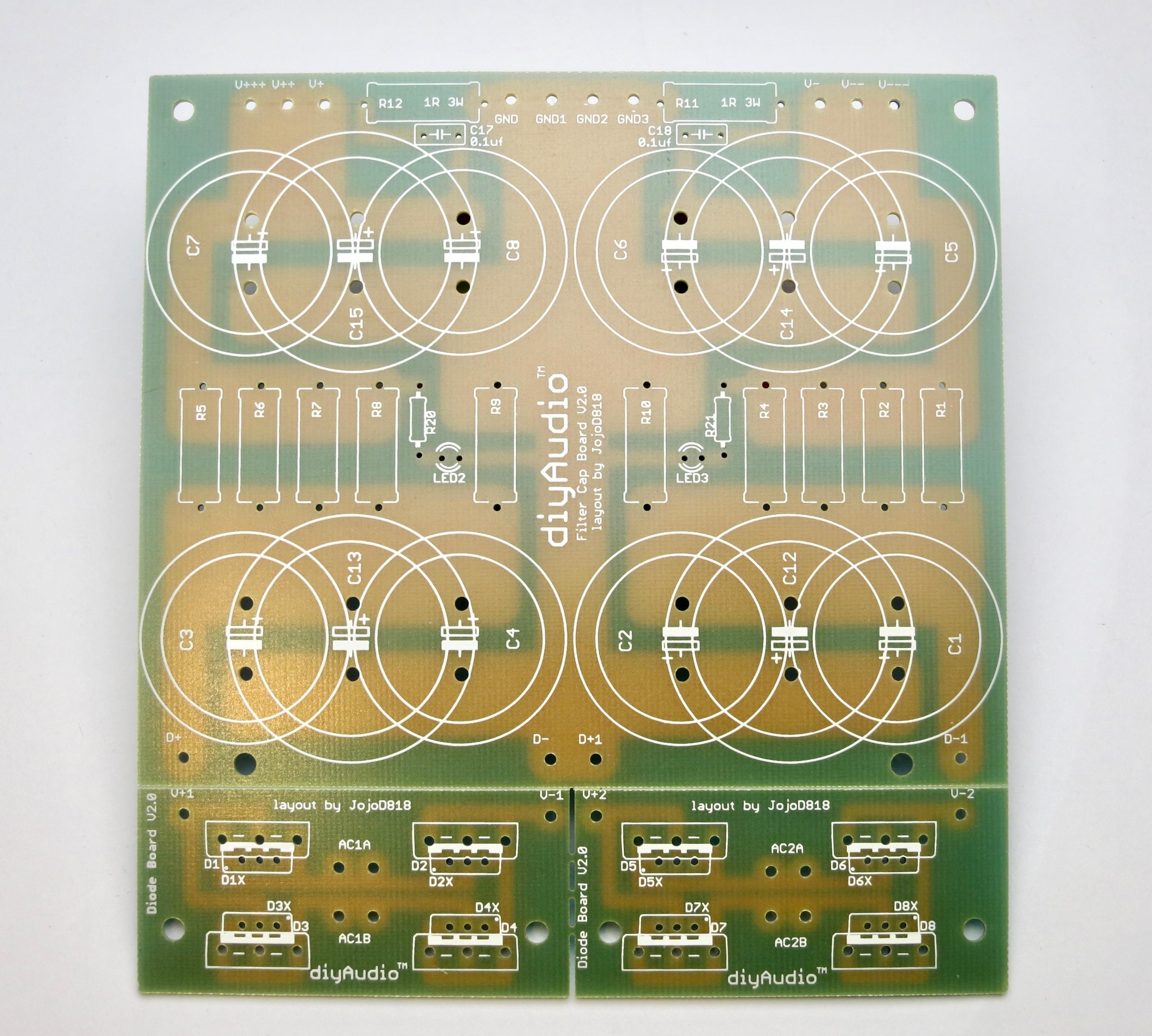

I'm planning to use this board for my VFET 2 and Pearl 2 builds. But I've been unable to find any information or posts for the JojoD8118 v2.0 filter cap board.
I picked up a couple from Variac at BAF a couple of years ago and could use a schematic if anyone has one.
Specifically, I'd like to know, what should the values of R20 & 21 be?
Also, are the 0.1uF caps C17 & 18 snubber caps?
Thanks to anyone who might know.

This should help - (click the image if it's huge or squished)
R9 10 are bleeder resistors, 2.2K 3W works great, but not very critical at all.
R20 R21 are for the LED, value to taste, if using modern LEDs that are silly bright, try 15K.
LED holes will be long leg to the left when looking from top, since that's the more positive side. (think about it for a min...)
R11 R12 C17 C18 Are the output snubber, it's easiest and best to leave these empty.
Diodes are center cathode.
