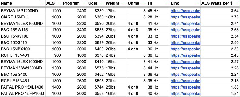

Just starting out in my journey here. I am purchasing a couple Martin Audio Blackline XP15s and want to build my own subwoofer to compliment them for dance music events in the Boston area. I've been reading in here for a few days and I've decided to head towards building @chris661's Teeny Tiny PA 15". I need to learn how to use Hornresp and keep educating myself, but I intend to engage in more dialogue here soon. In the meantime, I have compared available 15" drivers in the USA and want to share that document with you as a peace offering. This is limited to Neodymiums with at least ~1000 watts AES Power Rating.
https://docs.google.com/spreadsheets/d/1nFezzD2rRuHEl3OoiFVE_G_wkyETeRWkpqqxkhpWy7Q/edit?usp=sharing
