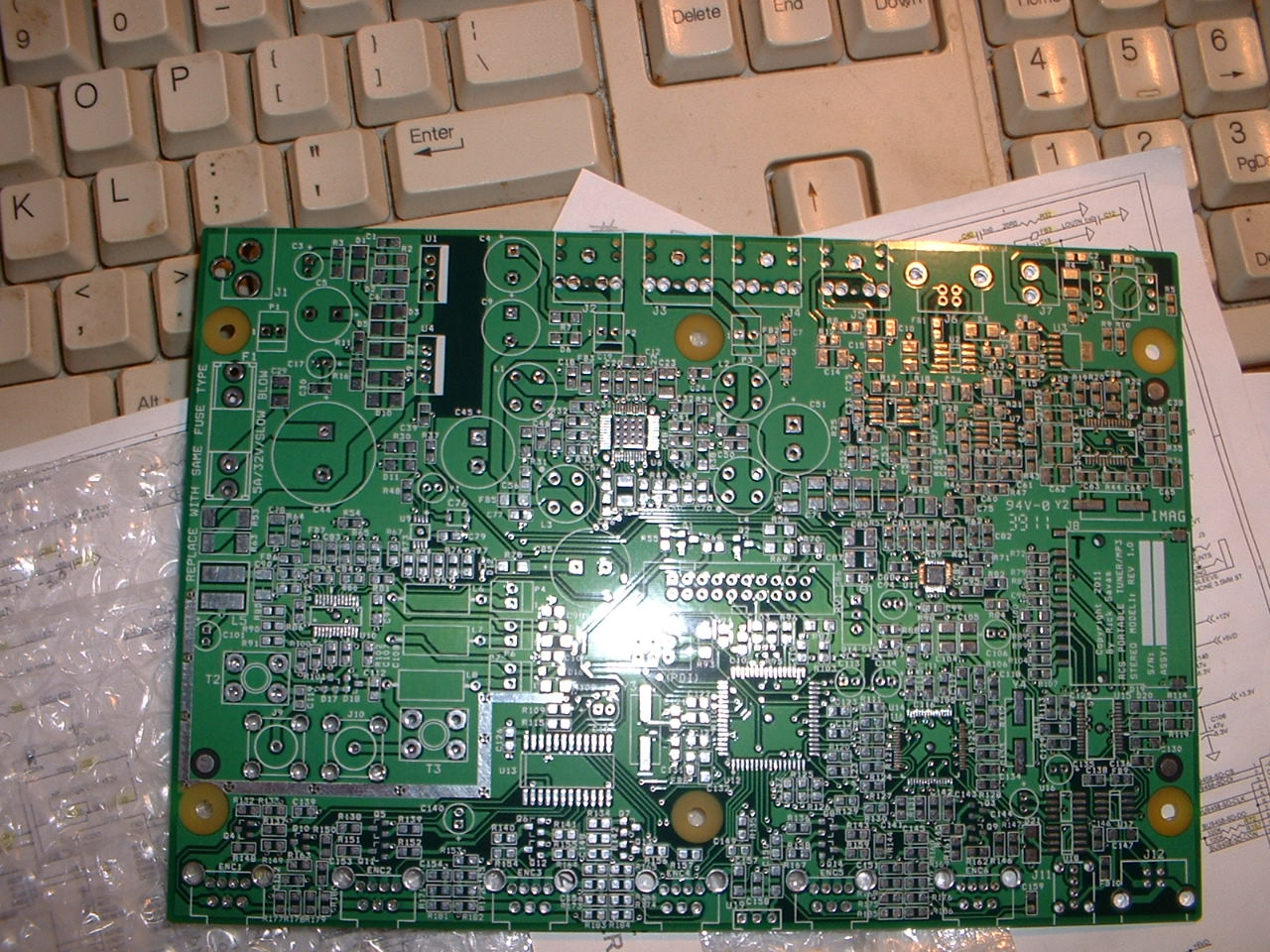

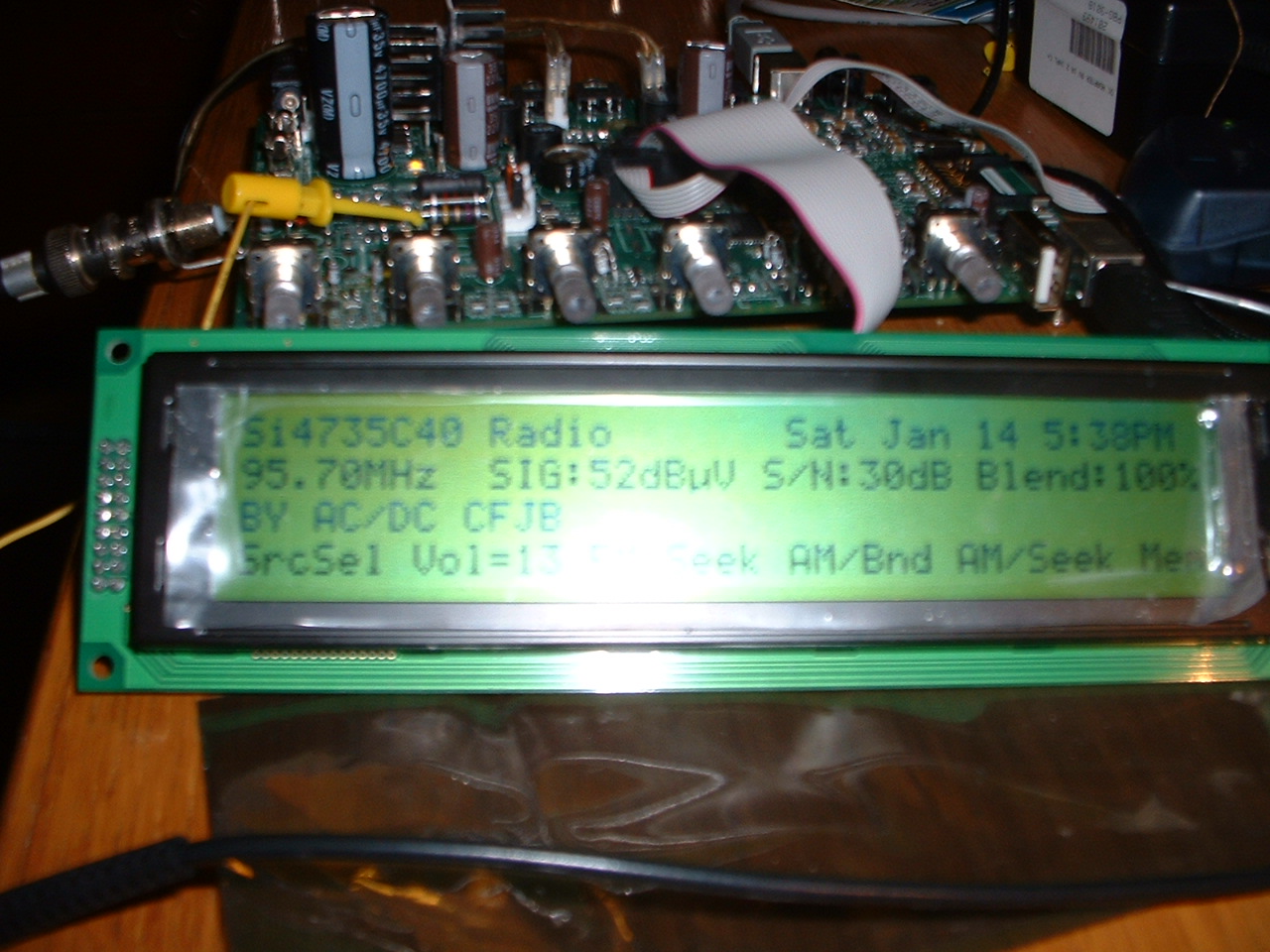

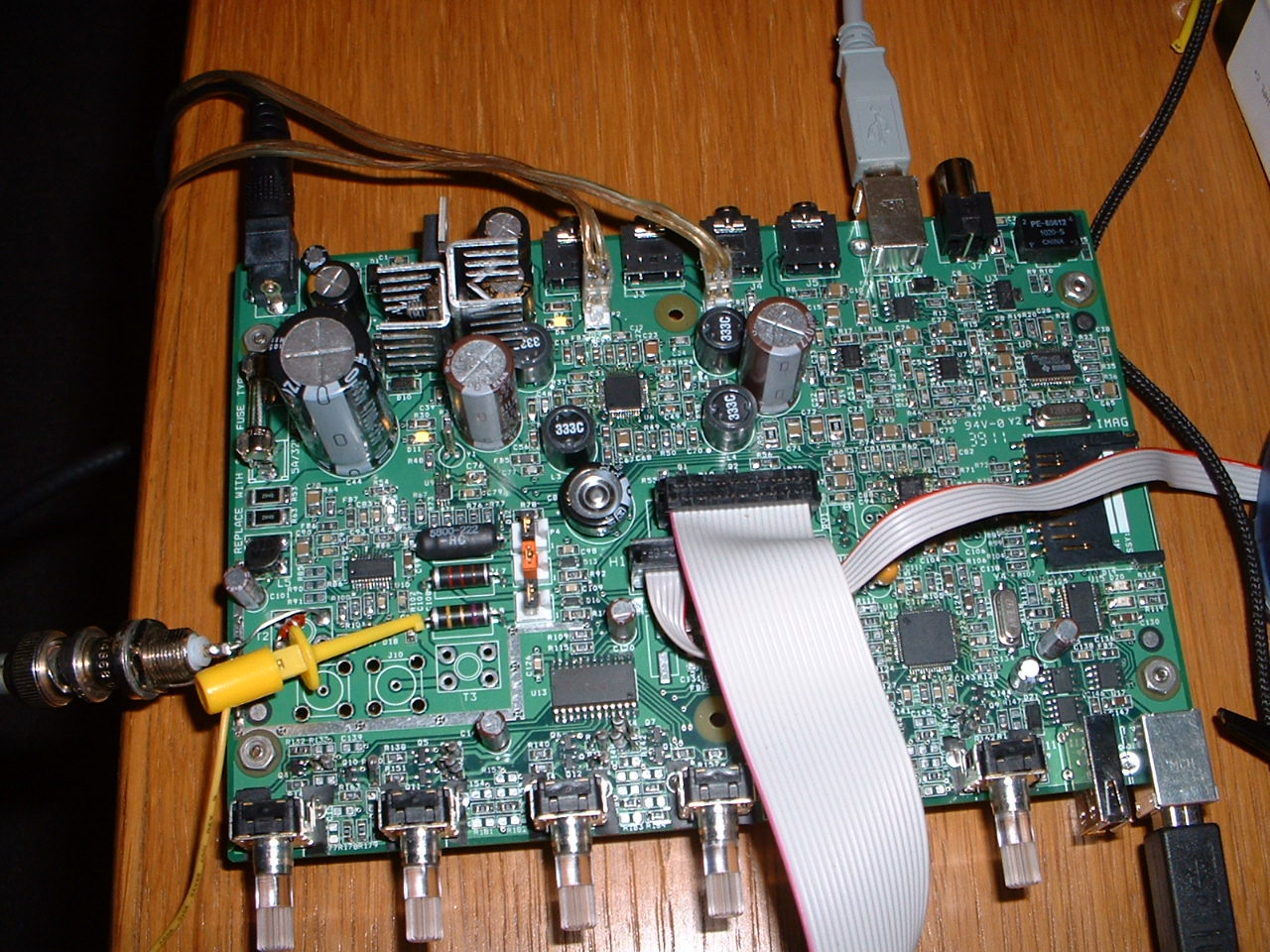

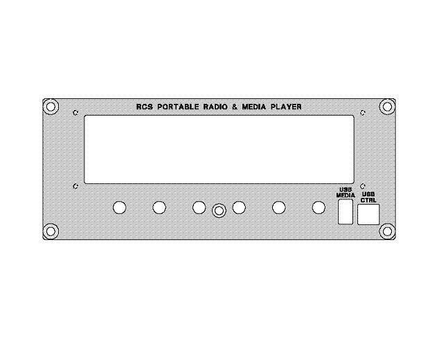

Hi Bob,
Working on the Si4735 was a fun learning experience for me. See attached pictures of the portable tuner/media player.
I wonder what the Si4735 would sound like with an external DAC (I2S output)? I guess that I will only find out if I give it a go, yet another project 🙂 . This is what I was planning for my tuner/pre-amp project, but it got a bit much, so I scaled it down a fair bit to get my programming experience level up to snuff.
