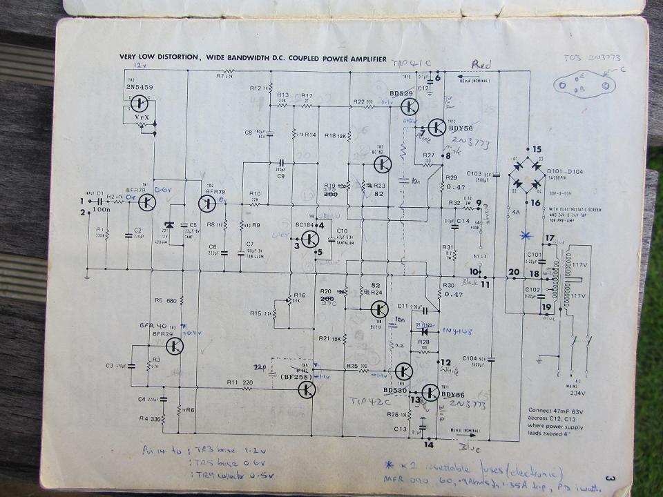

I have a problem with my left channel of my JLH 80 watter. It's the last single PCB Wiliams Hart version - not the Hart version with separate boards for power supply & amplifier.
Does anyone have a copy of the kit instructions with circuit diagram & parts list for the Williams Hart incarnation of the JLH 80 watt amp (mono or stereo - it's the same board).

If this is the VMOS design presented in ETI many years ago, I still have the mag buried somewhere in my belongings...😀
If someone else doesn't chime in, I may be able to dig it out. Will take some time though....

It looks like this :
J picture by bloodyhell451 - Photobucket
Hope you can see it - I'm new to photobucket.
Any help greatly appreciated -

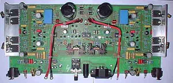

The PCB was updated by Williams Hart electronics in the late 90's or early 2000's - third version. (Hart electronics was the original kit/PCB supplier that worked with JLH ) - Think one was '84 and then updated in '89 (PSU board wrapped around the toriodal etc and some updates. The very early ones I have seen photo's off. I have the later ones.
The reason for the new PCB (third) apparently, was that the performance was more built in - things like earthing etc, psu and amp on same PCB, and using newer plastic lateral mosfets (not T-O3). With the older PCBs there was alot you could do wrong constructing it if you where a novice.

As a follow up - I had the Williams Hart mono fixed. It turns out that the output transistors had blown - taking out some zeners as well. The engineer had quite a time.
I can confirm that the circuit diagram and the parts list is the same for both versions - though the Hart version is closer to the original design - running a higher quiescent current than the Williams Hart. The heatsinking arrangements for the Hart are better - the L shaped plate in the Williams Hart version is not up to the same standard. This is going to be the subject of a futre project.

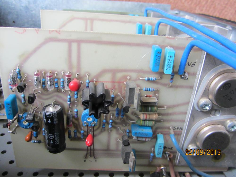

I had a powertran kit deluxe. It had several serious flaws that meant the amp was always on the edge of blowing. the construction was put in too thin a box that provided insufficient heat sinking. also the boards were overly complicated in 3 sections that could twist.
i redesigned the boards completely to end up with a monoblock. the power supply board was redesigned and i have photos of the board design that allows one to be etched.

further ... if you check ebay pages it shows the 3 boards. to increase the fidelity and low frequency attack , i upgraded the smoothing capacitors and went for the latest quality and put independent pairs for each amplifier as well as separate ac to dc zener circuits.
You have definitely misunderstood.
The heatsinks confirm that it cannot be a ClassA amplifier.
If you gave details of the build, we could point you to what else confirms that it cannot be ClassA.
