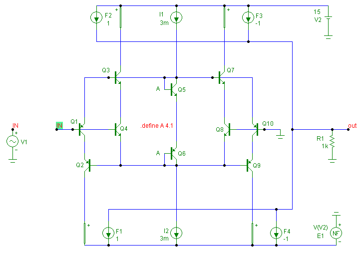

As Wavebourn said there is more than one way to skin a cat. Here is the AD8099 input linearizer (which does NOT compromise the noise unlike the tanh technique), US6963244. You would like Nathan a lot, he was at the Bongo dinner too 🙂. You probably need to read the patent for a full understanding. This was one of two techniques in house and his won.
Hi Scott,
I fiddled around with this idea and results were very promising. By adding cascodes, the tail modulation circuit gets really simple. 🙂
Regrettably one will need an exact ratio of emitter areas (~4.1), not easily achieved with discrete components. :sad:
BTW, why was this (rather obvious) variant not covered by the patent?
Edmond.
Edmond.
Maybe headroom? I would have to look. There is already a new variant to handle this issue. It's becoming hard to sell amplifiers that don't go to one rail on the input and both on the output.
I still think this circuit would be more amenable to just "piling on" to make the 4X diodes. You can still get good results with 4 to one and here you just have two diodes to make, in fact I think getting the right total delta-Vbe across both is good enough since this is again a translinear circuit. The 4.1 IIRC is the same ideal point as the multi-tanh.
Hi Scott,
Does this mean that cacoding is an obsolete technique by now?
Agreed, a ratio of 4:1 is good enough (if that's what you mean), but a THAT300 chip for example, only contains 4 match trannies, while we need 4+2=6 of them.
Of course the same ideal ratio applies, because it's essentially the same circuit. It only differs in that the modulation current (through Q5 & Q6) is directly subtracted from the tail currents (via the common emitters of the input stages), instead of via additional current mirrors (Q11,Q12,Q15 & Q16 as in fig.5 of the patent)
Also notice that in my variant, Vcb of all input and modulating trannies is kept at the same level (i.e. 0V)
I'm checking into the third technique.
Yes please.
Edmond.

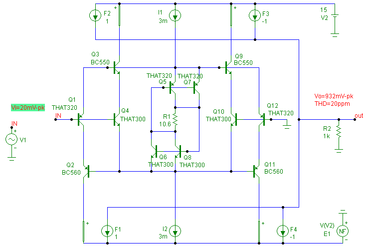

I was wondering this morning if combining Vbe's and a thermistor of just the right TC might make one of these work in discrete form? Sort of a TC compensated area cheater. Do you know what I am refering to? Take a diode connected transistor and put a small resistor from base to collector and sample the diode voltage at the collector. I have not gone through the math on this technique. Your circuit is an excellent variant BTW it should make clear the operation to everyone.

No, just the brute force techniques like those that included another level just to accomidate Ib comp transistors are not that useful anymore. Two volts from each rail does not leave much on a 5V supply 🙂 .
I was tinkering with that idea too, but it's not that simple. If the cuircuit also depends on resistor values, much chance that it also depends on the value of the current sources (I1 & I2), making things even more complex.
Below an example of a DIY version based on two THAT chips.
As already pointed out, the optimal value of R1 depends on Tamb AND I1 & I2!
Edmond.
edit: >Your circuit is an excellent variant BTW it should make clear the operation to everyone.
Thank you!
