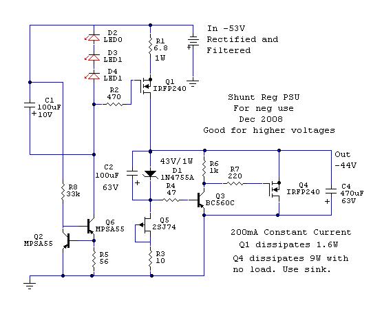

nicoch46 said:John I ask you becouse I cannot find a good answer ,
were is the right place to jont the 0V ? after the shunt ,or fist or second caps ?
You should join points with the lower dynamic resistance between ground and rail pins. Near caps in this particular case. If caps have low values they have to be placed as closer to shunts as possible. But as soon as they are shunts, I suppose you are going to power preamps, so own RC thingies most probably will present on each board.
