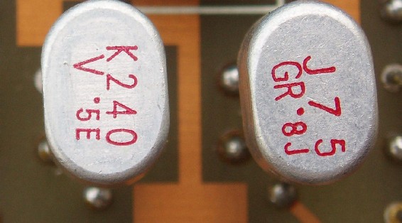

I was quite puzzled with some choice you made with the Dennesen JC-80 : you used consistently 2SJ75 GR grade against 2SK240 V... (see the attached pic). Not quite in the same Vgs and Idss league, as the J113 and J175... It is VERY interesting because you used all them very soon (J175 and J113 since JC-2 IMO, 2SJ72 and 2SK240 since Dennesen...). The close (ahem ! spreads to x 3 factor !) complementary data Jfets data book claim is quite wrong, and your own EXPERIENCE with them (and not only experiments) show it as an evidence... Without this trick, for sure, I would have gone some cross matching attempts that would fail at most... Here, you are not only saving me money, but lots of matching time ! Really, you are both a great engineer and a great guy, John... Just designing sport engines but also with both hands in the used oil... (LOL ! Somewhat a French expression almost impossible to translate right !).

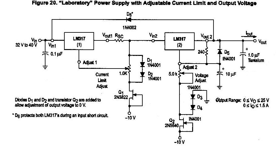

But returning to the dual LM317 trick, you seem to approve LM317 successive stages in the quite normal use (both series). Wouldn't another approach be far better : the first LM317 in a current source configuration feeding another LM317 in the common series configuration... Would be just a power equivalent, IMO, of a constant current source feeding a precision zener diode or voltage reference... Just like in this attachment from a Motorola note...

I am not so sure that the current source is effective AFTER the LM317 in a regular series regulation, and specially if John runs all audio boards in full Class A (and I bet they do !). The current drawn would be shared between the charge and the amp board, but the whole current taking will remain unchanged, and will be a constant one... So, IMO, to put a LM317 in current source configuration AFTER then LM317 in regular series voltage regulation won't help.
So, I would better advocate for the two cascaded series voltage regulation already proposed. But... My own guess is that a single LM317 in usual series regulation scheme would suffice to have the job done fine... Two cascaded series LM317 wouldn't improve really voltage regulation but perhaps a little reject unwanted rubbish noise... So I will stay with my own power current source feeding a voltage reference analogy. But didn't tested this two configurations yet, and compare them... Has anyone ?

JB, the use of V and GR components together is unfortunate, and not possible as a true match. This is a mistake of the preamp manufacturer, and not recommended.
How one makes the combination of series-shunt regulators is not well defined, and many approaches are potentially acceptable.

Thanks a lot for the input ! The Dennesen JC-80 is crowded (ahem... Just a few pairs...) with such strange things...I understand now that your own schematic didn't showed unprobable matches like these ones, and that only relies to Jim Dennesen... First, I thought that you had perhaps found that the P-channel high Idss class just matched the N-channel low end of the class...
