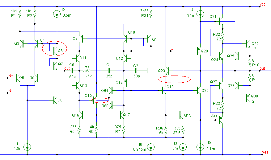

Ad797
Hi Scott,
Are sure that this is the real schematic (AES preprint 3231, fig. 3a)?
There are a few things that puzzles me and/or makes no sense:
1. Q61, unless the bases of Q3 and Q4 are tied to the collector of Q61 instead of to the collector of Q7.
2. Under normal conditions Q50 is conducting, which spoils the whole thing. If I break the connection between the base of Q15 and the emitter of Q50 the circuit (almost) behaves as expected.
BTW, is Q50 meant to ease the recovery from overloading?
3. Bootstrapping the collector of Q19 instead of Q18. The latter makes more sense as no non-linear Cob loading (by Q18) of the input of the output stage.
Please, see below for my suggested mods and, of course, correct me if I'm wrong.
Edmond.
scott wurcer said:[snip]
BTW that is the real schematic, there are no hidden surprises AFAIK except the offset null scheme might be different in reality (very lame HP plotter schematic).

Re: Ad797
1 and 3 make sense, I need to be at work since I don't have a copy at home. Sometimes clamp devices get drawn in a way that makes no sense.
Edmond Stuart said:
Hi Scott,
Edmond.
