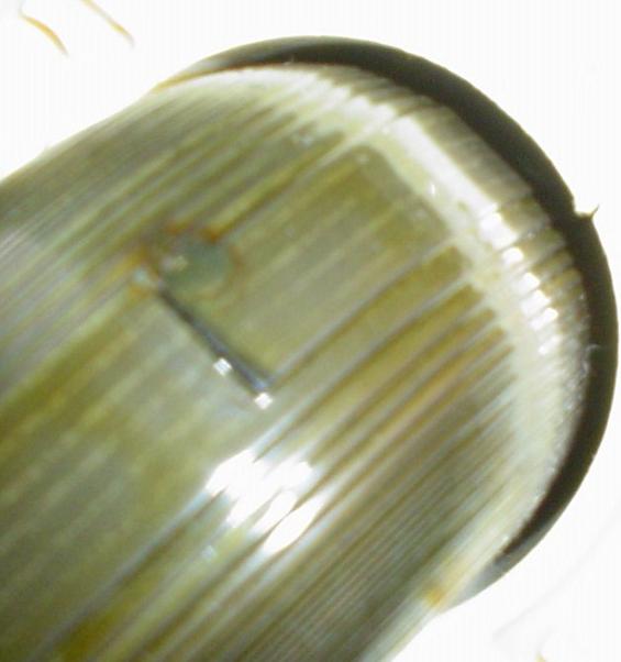

No R-core transformer I have seen appears to have any core "gap" as you suggest here, and I wonder if you are thinking instead of C-cores. All the R-cores I am familiar with are constructed in the same manner as toroids being 'wound' from a long thin strip of steel, but in this case the strip is tapered towards each end so that the final result is virtually circular in *cross-section* through any part of the core.
However, unlike toroids, instead of also being circular in 'plan' view like a donut, R-cores look more like a Race-course (hence the term 'R', I was led to believe, but this may not be so!) with two longer parallel straight sides and curved ends. I haven't destructively tested their constructions to be 100% certain, but from the dual-part plastic bobbins used, I assume that these cores are not split and then later joined (like C-cores are), but as always, I could be wrong. 😉
Secondly, as I mentioned before, after discovering the sonic differences with alternative mains orientation, in order to decide which way to connect my transformers up *before installing them*, I do the check on the bench to avoid later re-wiring, and at that stage they are merely loaded with a resistance. Accordingly, no diodes or anything else for that matter can affect this massive change in radiated fields which I can measure, albeit not quantitively. As I also said, the fields are actually worse when the transformers are loaded, in my experience, when compared with unloaded or 'freewheeling'.
Thirdly, I have never come across any readily-available 'standard' (generic) type of toroid which has an electrostatic shield, and most (unwitting) users will doubtless purchase such items because they mention this (and the manufacturer's/supplier's names) frequently on this Forum. Additionally, I look at numerous catalogues/websites (from all over the world) supplying these items, also some specialist audio components suppliers, and it is clear from the illustrations they show that these also do not include an electrostatic interwinding shield which is vital to reduce (regrettably, not eliminate entirely) capacitive coupling of mains hash etc.
For any such interwinding shield to be effective it must be grounded, and accordingly a suitable grounding wire is required, and one never sees these additional wires except for rarely when the transformers are deliberately made in this manner. I need to have my toroidal transformers bespoke made in the UK to enjoy these kinds of benefits, including a GOSS band to supposedly reduce overal emissions.
More recently, using R-cores has proved to be sonically preferable when directly compared with either "E-I" or toroidal transformers, and I tend to favour these now, although they are not so freely available, and certainly there appears to be none fabricated in the UK unless my extensive enquiries have failed me. This is very likely to be a licensing/patents issue as far as my enquiries show.

Have you ever compared an R-core to a toroid with electrostatic shield? It is easy enough to have a toroid custom made with a shield.
Regarding R-core, I always assumed that "R" stood for round cross section, as that apppears to be the only fundamental difference I see over other types. This allows the bobbin to be spun around the core while winding, and also provides a more even flux density through the core.
Also, I was under the impression that the primary was wound on one bobbin, while the secondary was wound on the other side. I guess it doesn't have to be done this way, but it would seem that it would have to be done this way to reduce capacitive coupling between the primary and secondary, which is said to be an advantage of R-cores over toroids. Otherwise, a shield would be the alternative, and that could be done with a toroid.
It is well known in diy circles to orient the polarity of a transformer. The leakage capacitance of the windings to ground is different for each polarity. This can be easily measured by disconnecting the center tap from ground, connecting an ammeter between the center tap and the grounded chassis, and orienting the primary polarity for the lowest ground current.

Regrettably I cannot speak from experience of this particular range of transformers, but I would be extremely surprised to learn that these are any different from a large range I have experienced from suppliers from all over the world.
I am not quite so familair with E-I types, if that is what this series consists of, as I haven't used E-Is for many years, but those I have tested were quite similar in exhibiting different fields (and sonic results) with alternate connections from the mains to their primaries.
I haven't ever had the chance to stand these two types of same VA transformers side by side at the same time, unfortunately, to make any direct comparisons. I only went over to using R-cores more recently, and the opportunity will arise at some time when I have one of each of same ratings together, so I will be able to compare at that time.
Also, as admitted before, my tests are not definitive nor calibrated (to satisfy the meter readers) sufficiently to accurately relate from one test to another which was carried-out some time later.
However, my overal impression is that R-cores are generally quieter than toroids, when compared like for like, if that helps.
You may be right about the origin of the 'R' in R-core, and I suggested that my impression might be wrong here.
I also believed that primaries were wound on one side and secondaries on the other for precisely the same reasons which you mention. However, as mentioned, I haven't (yet!) tried to take one apart or modify one in any way, and the origin of the wiring in those I am aware of was hidden completely under some insulating shielding, so I cannot be sure.
