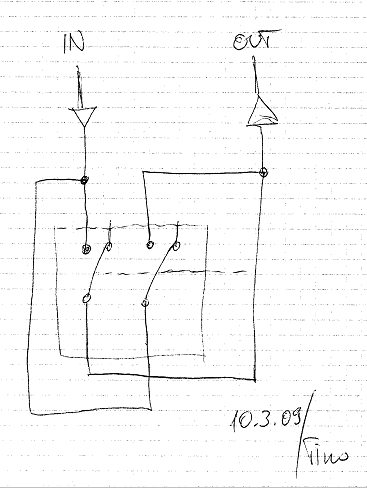

The following taken from my post #7511 in this thread may shed some light on the matter, and I made some other relevant comments in post#7517.
"On the matter of Shallcos (and the similarly-constructed Blore Edwards) one of the most important issues here is the overall 'integrity' of the signal-path through these 'good-sounding' switches, by which I mean the least detrimental to the signal. The input/output connections are soldered directly to the rear of a small single solid piece of silver, the other end of which is the actual stationary contact. The wiper arrangements are similarly 'minimal', and there are no dissimilar metals riveted to each other nor convoluted signal-paths which one finds in most relays which I have inspected internally."

Bobken said:
........and there are no dissimilar metals riveted to each other.............
Thermoelectrical and maybe other issues could be avoided using a DPDT relay, wired in "antiparallel". Did anyone try such an arrangement?
Ciao, Tino
