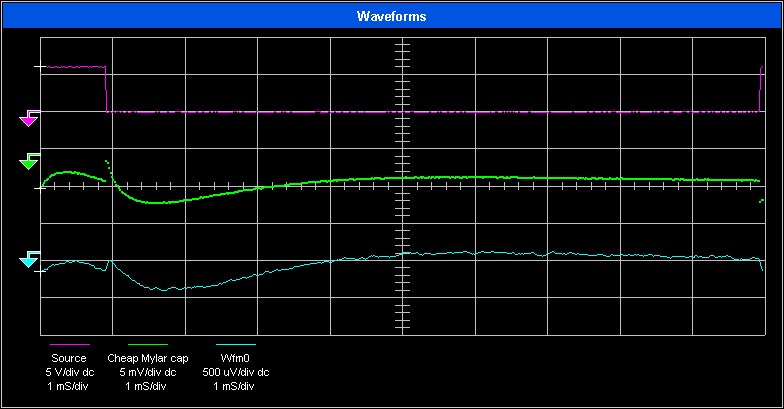

I set up a fixture similar to John Curl's with a few changes to measure the MLC sample I have. I used a Tek 7a22 preamp and a matched pair of P6055 probes to look at the differential. I revised the bridge a little, drove it through a transformer to reduce the HF common mode stuff and created a synthetic reference at approx the differential potential (the reason for the transformer isolation).
The top is the source waveform- a 1 mS pulse with a 10 mS rep rate, the middle is a cheap mylar (I couldn't find a generic X7R Ceramic) the bottom is the NPO multilayer ceramic. The scaling is accurate- the middle is X 1000 and the bottom is X10,000. Getting a balance at these ratios (CMRR of 10,000) at the higher frequencies is very difficult. The differences from the reference cap ( A Component Research film and foil Teflon in a plastic case with pure copper non-magnetic leads) is very small.

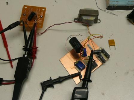

Cap Diif measurements pt. 2
This image image shows the test setup and the Teflon cap (the big black tube) and the MLC cap (the yellow rectangle). The smaller MLC may make for better overall designs, with less area exposed to collect em radiation.

John:
Yes, at least 10X better than the Mylar. I'm really a the limit of measurement with this for now. Possibly lowering the input band limit would make it easier to go a little deeper. I could get 5X more but I'm not sure about the uncertanties of the measurements going that far.
The big NPO's aren't cheap. And asking for 1% brings a huge premium. I'm not sure how to use them commercially yet. And I need to get Asian samples to see if they are consistent in performance.

Demian,
Interesting and revealing. I might have missed it, but how is this measured? Sending the puls into the cap with the other side loaded to ground? What's the load impedance?
