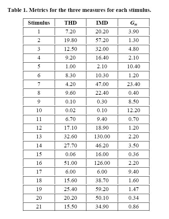

I thought Dr. Geddes work concentrated on perception thresholds of various kinds of distortion. Extrapolations are dangerous and not necessarily valid for very low levels of distortion. Just because 10% seconds sounds better than 2% sevenths (making it up) does not mean anything at the .001% level.
In my experience SE amps can have clearly audible coloration and still be prefered by listeners. Yes, audible even to me 🙂
You might want to read what Geddes says on his website?
I am pretty sure I read it, and he refers to 0.001% distortion amplifiers and higher distortion amplifiers in specific.
The relationships are NOT a function of absolute level, but a function of SPECTRA! according to Dr. Geddes. At least as far as I am able to understand.
You experience with SE amps is rather irrelevant to what I wrote about. And yes, you can make almost any type of amplifier have colorations, good and bad ones. The point I made was not about colorations in SE amps.

I have, there are no controlled listening tests where all the distortions are at vanishingly small levels. Please tell me what I am missing>

bear said:The relationships are NOT a function of absolute level, but a function of SPECTRA! according to Dr. Geddes. At least as far as I am able to understand.
Earl's distortion criterion has nothing, zilch, nada to do with distortion spectra directly. He imposes distortion digitally via a static nonlinear function. That is, if the input word is x and the output word is y, the nonlinear transfer characteristic is y = g(x), where g(x) is some nonlinear function. The Gedlee metric involves a mathematical operation on g(x). It has nothing to do with the spectrum of the resulting distortion (except in a very indirect way), only with the relationship of y to x.
