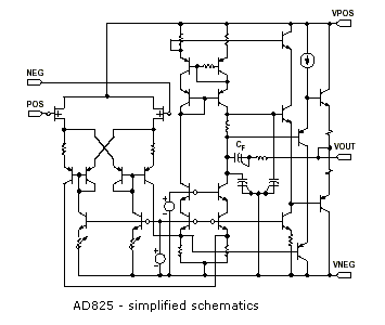

john curl said:OK, Scott, how about AD817,825,and 829? They have a similar 'equivalent circuit' to your AD797. Who designed these parts, if it isn't a company secret, or something?
Not AD825, it is quite very different.
