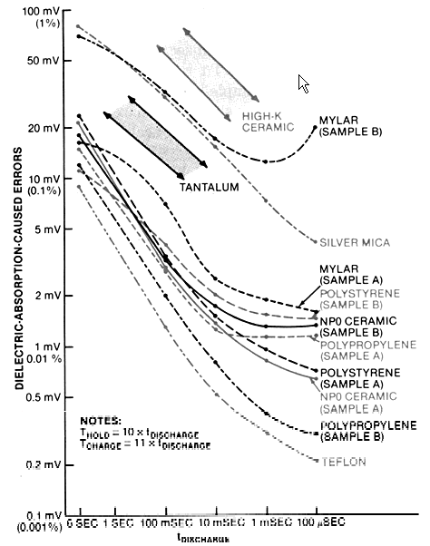

I thought so, PMA, AND it is that 100-220pf cap on the input that I often worry about with the mid-fi designers represented here. This is where it is difficult to notice, at a glance whether the cap is NPO or something more compromised. IF not non-linear distortion, then DA can still be significant in many compromised caps, other than polystyrene, polypropylene or Teflon. Mica is also marginal, BUT easily identifiable as a device, so that I know where I stand, at a glance.

Chris, here's an off-the-wall question. I'm in need of a Miller compensation cap for a high-power amp with boosted front end supplies (+/- 100V). So I need a cap with a voltage rating greater than 200V of course. I was originally going to use mica here. But the data from Bob Pease's 1982 article on DA (attached below) shows mica to be inferior to NP0 ceramic with respect to DA. Now I seem to remember syn08 has done some research showing DA to be a nonlinear phenomenon. This cap would of course see the full output voltage swing, so its nonlinearity could conceivably be a concern for a sub-ppm THD design. So I thought I might look to see if there were any NP0 ceramics available in, say, a 500V rating. The Mouser catalog shows that the cheapo Xicons meet this requirement. They make a 39 pF, 500V NP0, which is just what I'm looking for. Have you ever tried the Xicon NP0's?
