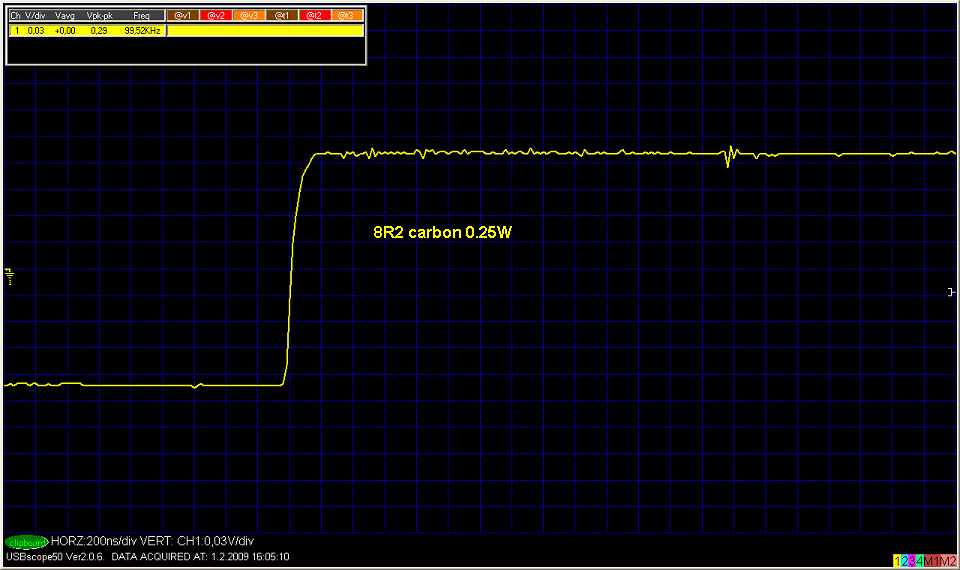

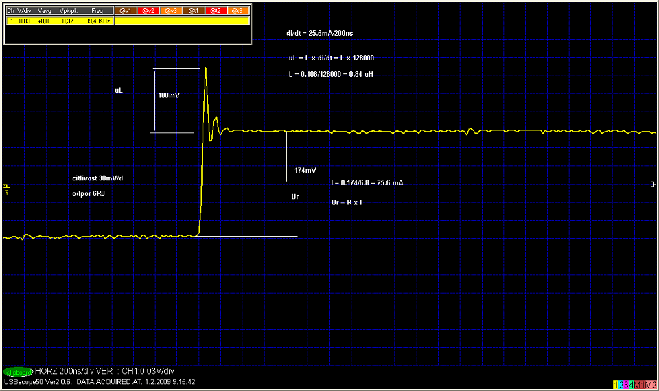

PMA said:
I would like to know what kind (technology, manufacturer) of Re emitter resistors in power output stages are recommended (0.1R - 0.22R values). IMO they make a big difference. Their inductance contributes to stability/instability in a high degree, as well as PCB tracks to/from them.
I did measure some power resistors in the past - many have very measurable distortion at 1 A current level (0.01-0.1%). I don't have results now - perhaps one day I will repeat my experiment.
Me too 😉
