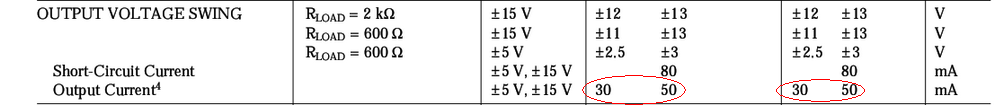

john curl said:SR=dV/dt=I/C=.055A/1.8uF=.03V/us Could this be a problem?
Sure. Try it from a different point of view.
5Vp, 20kHz
SR = 2 x pi x f x Vp = 0.628V/us
This voltage trying to drive 1.8uF cap.

Thanks.
I have though another option on the drawing board, much better I guess... Buffers are usually driving 100mA, exactly as much as AD797 is able to. There are a few high current buffers (like OPA634) but I'm not sure if it would be any much better.
syn08 said:Thanks.
Are you sure?
