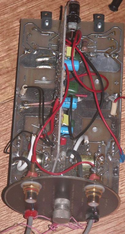

This TUBE Head-amp predates similarly styled cases from Musical Fidelity.
Now who designed this again ?
regards
James
regards
James
anatech said:My wife worked at Sonic Frontiers....
Seemed like a nice place to work. My strongest memory of that tour is what looked like a wall of US Army 211's purchased for a product they never released. Always wondered what became of them.
I still own a pre-production SFP-1 - model number 'demo'. Bringing this back to topic, it's a great looking case with a real clunker of a design flaw. The power supply and audio sections are separated by a sheet of steel bolted to the chassis floor but otherwise unfixed. It resonates like a washtub bass, easily audible by tapping the top. I understand it was rectified in later runs.

As far as the round case is concerned: This was designed by Rod Herman who was my business associate back in 1979. It was paid for by A. Michaelson, then of Michaelson and Austin, now boss of Musical Fidelilty. I just designed the circuit inside.
Steel, nickel, mu-metal etc tend to add a non-linear component to the audio signal. It may be small in amount, but many find it audible.
Acrylic, etc sounds OK to me, but it would probably be an even worse shield than aluminum.
Yes, Rod Herman also did the circuit layout. It was kind of lousy. Picked up hum, even with a battery supply. Couldn't tell him anything though about his layout, because he quit and joined SOTA,
john curl said:Yes, Rod Herman also did the circuit layout. It was kind of lousy. Picked up hum, even with a battery supply. Couldn't tell him anything though about his layout, because he quit and joined SOTA,

I don't do layouts. Carl Thompson, the 'T' in CTC is the layout expert. We use a lot of ground plane, high quality materials, and short path lengths.
