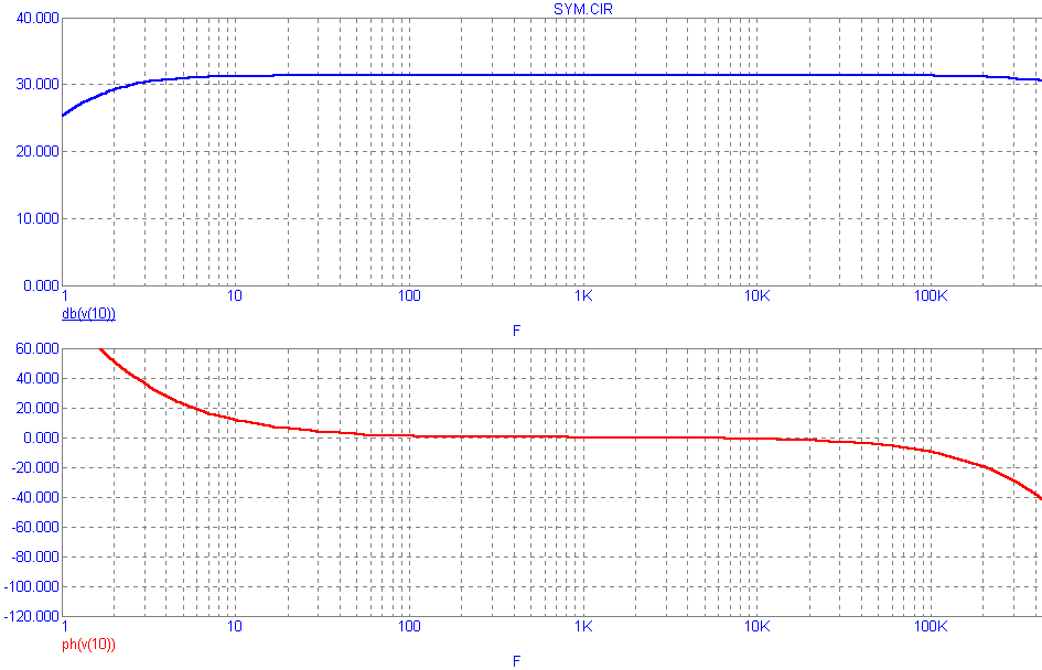

This is a total nonsense, demonstrating how the "marketing science" washes brains of the poor DIYers.
Phase reponse is unambiguously related to amplitude response. Wide amplitude response means minimal phase shift in the midband. For the system with bandwidth 2Hz - 300kHz (which is quite normal) there will be no interesting phase shift in audio band.
Panelhead said:
This artifact of playback indicates that the phase is fairly flat across the midband. Plus no frequency related delays.
This is an area where the lack of feedback is beneficial. Feeback usually screws with the phase response.
The attached picture shows amplitude and phase responses of the power amp that I use. It is a feedback design, OLG = 80 dB, OLG frequency cutoff corner (-3dB) > 20kHz, closed loop gain = 32dB. I would be grateful if someone could show me significant phaseshifts in the audioband.

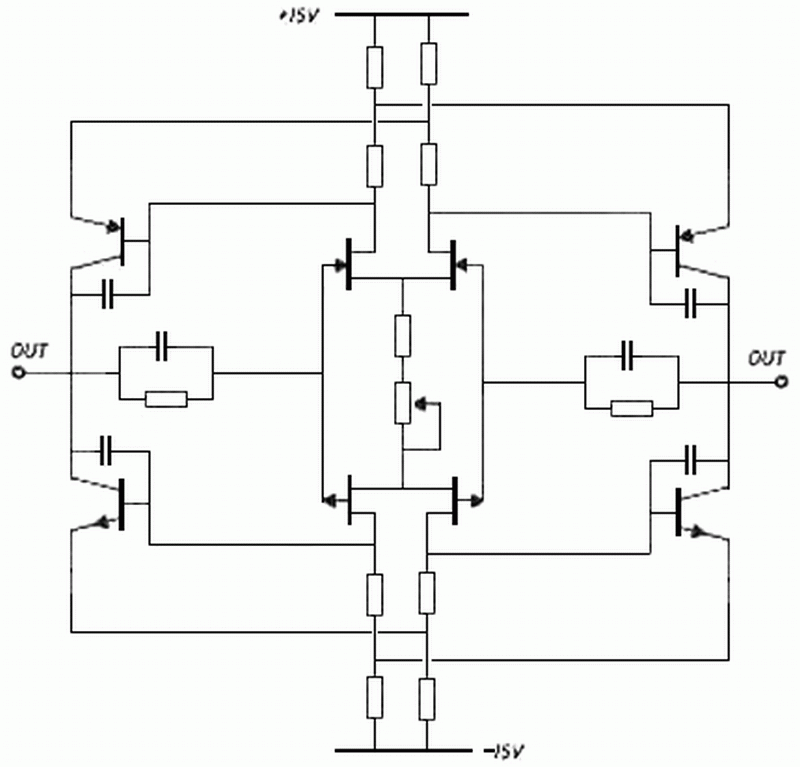

John,
Your comment several posts back about non-linear capacitance is interesting. Presumably, an open loop circuit with wide bandwidth either has little capacitance to begin with or the native capacitance has been scotched by various topologies, board construction, etc. The wide bandwidth and good imaging aren't necessarily causal to one another, they both just sort of naturally fall out of the circuit if you can tame the capacitance. The problem with testing this is that to change the capacitance (presumed non-linear, derived from the devices themselves), you have to change the devices or the topology or both. At that point, you're going to have a circuit that sounds different, regardless. Heisenberg could have been speaking of electronics instead of particle physics.
Unfortunately, I live in a very poor corner of the country. The chances of me ever hearing this circuit are slim to none. However, I have a kid entering Berkley this year for graduate work in chemistry and biochemistry. Any given county in California represents more money than my entire state. Perhaps I'll visit her and try to hunt down one of these things while I'm over there.
I don't have my schematic program with me, so I'll try describing something verbally, knowing full well that the odds are against me:
Assume something similar to the single-ended JC-2 line stage--a differential followed by an output stage that is both folded cascode (Source driven from one half of the differential) and common Source (Gate driven from the other half of the differential). Is it practical to use two resistors in series as the load for each side of the differential and make a balanced circuit that way (each output phase hooks to both sides of the differential, for a total of four connections to the front end differential loads) or does the Ciss of one output foul up the other output's Source?
If my description is too opaque, I'll draw it up when I get home.
Grey
P.S.: What do you call that topology? It's more than just a folded cascode, surely.
