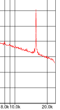

I tested about 20 different opamps for RFI sensitivity, in a high noise gain circuit. In our usual environment, we can easily find detection of TV row frequency or FM pilot. BJT opamps are MUCH more sensitive (in orders) than JFET opamps. Especially some BJT opamps are very sensitive, like new NS series.
You do not answer the question
RFI is many thinks and coupling has many different paths.
When you make an EMI experiment and you draw generic conclusions you should know if the coupling was conducted noise via cable pick up or radiated coupling differential or common mode, magnetic or electric or plane wave.
Correct knowledge induces correct use and design.
Your statments are more like in the old age where rfi was considered black magic. Then came Don White, Morrisson and all the others and it is now a complex engineering branch difficult but with methods of analysis/design and carefull measurement procedures.
I am not saying that you are wrong, I am saying that correct use requires knowledge, therefore my questions.
If your circuit shows rectification in a certain environment with bjt's and less with jfet it shows to me that your circuit is susceptible to EMI whatever the font end. Perhaps in another environment and with the same circuit, your fet input will be more influenced or something else in the circuit.
