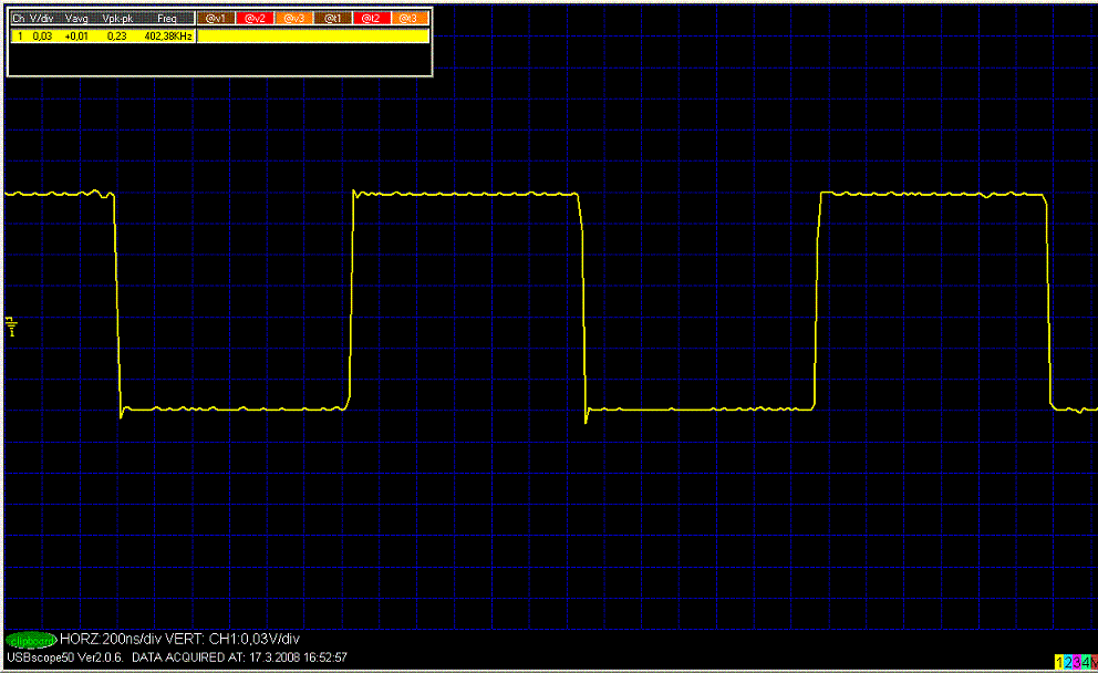

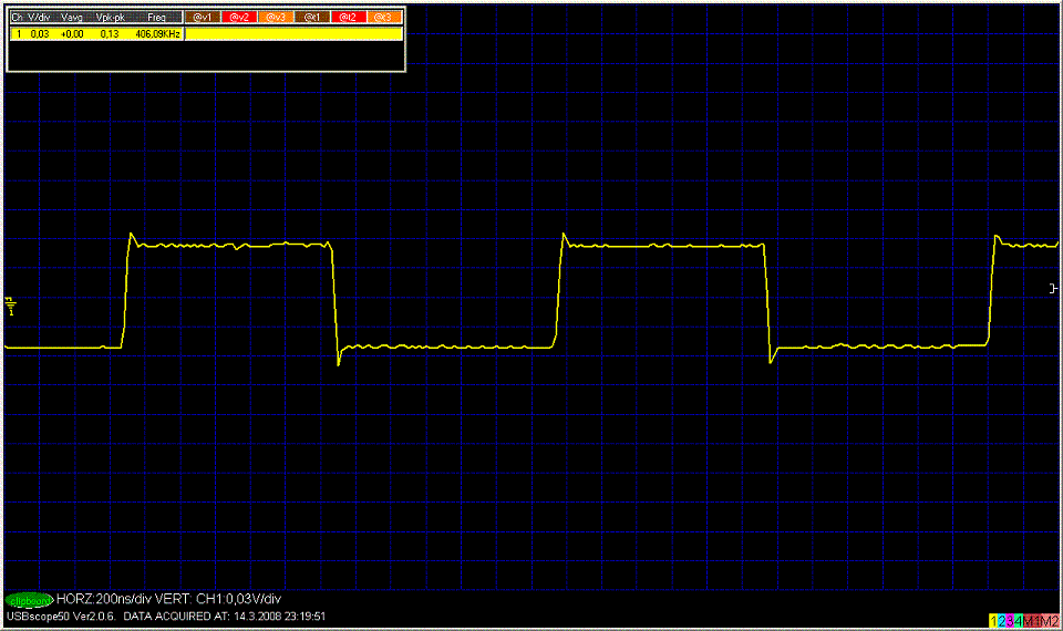

some opamps have never identical rise and decay part of unity gain step response, they are never linear for high frequencies, even for small signals. OPA134 is the one. You can mask this be preceding RC, or by reduction of generator slope.
For OPA627 we get better behaviour-attached.
The results shown were one of the reason why I moved to discrete circuits and insist on consistent step response for ALL amplitudes. The other reason, more important, is the sound 😉

you are deliberatly pushing the OPA134 with 200V/us which is way outside the specs of this part.PMA said:
But the OP recovers from this kick in app. 0,2us! 😱
Something you haven't mentioned and what seems quite impressive to me. 🙂

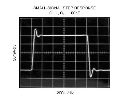

Intentionally. HF EMI and RFI does not ask us, if we are out of specs. And the datasheet does not say we must not use fast input slope.
We get this from datasheets, which is no way true for 100pF cap load. Maybe they use variable slope generator to get nice pictures?
I don't see a large difference to your measurement.
Small differences from experimenter to experimenter or between equipment/parts are quite normal when doing experimental stuff. 🙂

Juergen Knoop said:I don't see a large difference to your measurement.
RF could be filtered out prior to the amp. I see this more as a circuit design issue, than as a part property.
regards
There is a difference, as my measurement has different positive and negative overshoot (for OPA134, and not for OPA627). I would vote for lower slope derivative in their meas.
"RF could be filtered out prior to the amp" - only in case you fulfill design rules of HF instruments. Almost no audio gear does, and there are many ways how RF/HF spreads through poorly HF designed instrument. Forget simple RC somewhere, it is easily bypassed.
maybe, you are using a different generator etc.There is a difference, as my measurement has different positive and negative overshoot (for OPA134, and not for OPA627). I would vote for lower slope derivative in their meas.
So I wouldn't expect any measurement exactly equal.
My point would be, that this cheap OPA doesn't perform bad.
Of course there are better, more expensive OPs available and some people even build discrete designs with fare more superior step responses. 😉
A shy question: when measuring at such high speeds, have you properly terminated the coax? The HF pulse response depends dramatically on the coax impedance matching at both ends. I recall testing OPA134 step response but I don't recall this kind of overshoot response (maybe I didn't push it that far).
But then I still need to understand why such effects are important in audio and why input HF filtering is not good enough.
From this point of wiev(step response) it is (IMHO) much better to use OPA in inverting configuration.
Well - fast measurement in time domain is a part of my professional job.

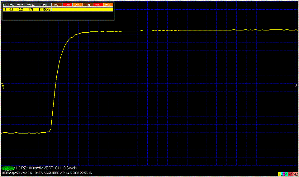

I have made several independent set of measurements, with 2 generators, Tek 2445B scope, and USB digitizer (pictures shown). Tek and digitizer results were same.
Output of opamps were measured in 3 ways:
1) oscilloscope probe, 10M//23pF (results shown here)
2) 50R resistor + 1m RG-58, no termination - many opamps become instable
3) 50R + RG-58 + 50R terminator, low amplitudes, because of current requirements. Some opamps, like LT1122, cannot handle this, unable to source transient current into 100R
LM6171, just to show quite perfect behaviour in time domain:
