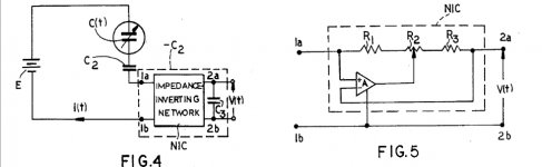

dimitri said:That is why Frederiksen idea have never been patented:
http://www.pat2pdf.org/patents/pat4281221.pdf
The drawings are strange (some parts are in series instead of parallel), but text is ok
This certainly can’t work. Where does the noise of R1 (expressed as an equivalent current noise) go? Why are the impedance levels G-Ohm in microphones, remind us John?

I never made any claims about distortion. In fact I have not yet made the analysis, because as you must realize the gain in my way is cut by increasing the feedback capacitance not by paralleling the capsule. I only said that I can get the benefit of the low noise of a 2SK170 without the penalty of the Crss, this I have measured. There is certainly no reason the distortion is any worse. But it's not my way as I have found Neumann, AKG, and others have used it. B&K's analysis is for the charge Qo held constant as in the voltage mode of operation. I have not found an analysis for current mode operation and don't have the inclination to do it myself. B&K is in the business of making traceable standard instruments not necessarily musical ones.

From Herr Frederiksen's paper...
The idea (patented) of using negative input capacitance for distortion reduction
seems to work well in practice but further experiments have to be made to
clarify all aspects of its use.

I wanted to ask for the B&K paper, but thanks Scott for the analysis, it is also useless, as the AES one John sent me...
I spent until 2AM reading the B&K paper, it is great stuff but as these things go if you read and at least sort of understand you tend to pick and choose what you want to hear. He talks about 140dB SPL that's 10V! right out of the capsule. So I apologize John, if you want to mic a kick drum from 6" you are right. We are just comparing apples and oranges. I don't want to stop down the mic I want to boost it.
I thought he AES paper was about dipole vs monopole transduction? The planar speaker guys know all about this. So it's best not to knock anything without reading and understanding.
Herr Frederiksen's paper is the one worth a read, there is even a nice graph of the results. But there was an AudioXpress article comparing a B&K capsule to a $1 Panasonic from Digikey with the source follower mod and the distortion even at 130dB was comparable. So let's drop the distraction and get back to the Blowtorch.

BTW Dimitri, B&K does have a patent on their method
Hi Scott, you are right. I made a quick search through USPTO and no US patent was issued
the actual one is AU6534694, EP0694246, WO9423547
The input capacitance is added to capsule capacitance. Additional noise is a result.

Yes, I already mentioned that with respect to the possible change to the 2SK222. The idea is with a simple impedance converter the input capacitance divides the signal and gives no gain so now you need an even better preamp. So in my case I have a 55pF capsule and a 5pF feedback and get 22nV noise out for a 1nV FET even with 50pF parasitic. So after the output you are working 22nV vs 1nV against the next stage. In the first case there are many easy choices that will no further degrade SNR.
The benefit is admittedly indirect.
