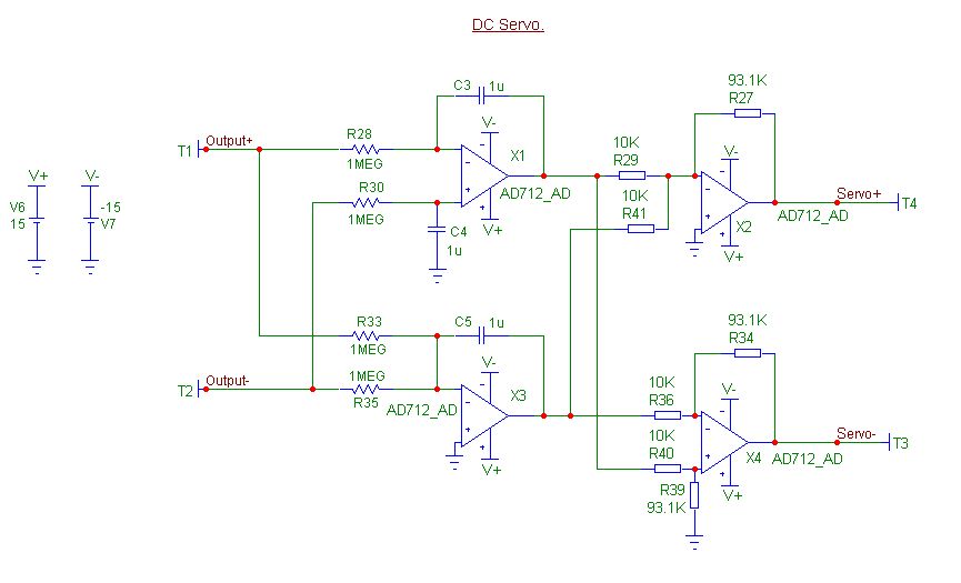

Each time I have used current sources in various circuits, from preamps to buffers or power amps, to get better PSRR, I come back to resistors. I use batteries (car batteries) to test my circuits, of course when the designs include CCS, switching from batteries to a mains regulated PSU, the audible difference is no or less perceptible but the sound is always worse than when I use resistors. That means, as John pointed out, that with today’s technology and knowledge (at least mine) it’s easier to get better sound using resistors (as CCS) and batteries (or a very very good power supply) than with a more sophisticated design using CCS to get rid of power supply deficiency.
john curl [] It is important where to return the servo to the input. The further down the circuit path, the better. The CTC connection is in the second stage, which is really the cascode of the amp. I use 4 separate connections. This tends to make the input to be less effected by the servo, which is probably a good thing. You might call my line stage a hybrid of servo and open loop only.
John, bear with me 'cause I'm a slow learner 😉
If the DC servo outputs (+/-) are connected in the second stage as you have mentioned earlier in this thread, are they not somehow in the signal path? Would connections at the JFets sources not be better??
Secondly, you mention 4 separate connections, which, if I'm right, are the 4 cascode points in the line stage. Are you referring ONLY to correction points or is it a mix of correction and sense points??
I know whe have discussed this earlier in the thread, but just ironing out some misinterpretations/ misunderstandings on my side.
Thanks again.

Given my views on current sources and their limitations, I try to use them only in places like the tail of a differential where the AC signal is minimal and the noise component has a chance to cancel via CMRR. Even then, a resistor is often better. People don't seem to realize that it only takes a few thousand Ohms to coax a differential into doing its job--not multiple Meg. Once you get above 10 or 20k, there's no real performance difference. At that point the CCS sometimes wins as a practical matter if you're drawing significant current because the rail has to be pretty high to accomodate the resistor.

Sometimes a current source is a useful thing to have...it's the "Well, of course we're going to use a current source there!" attitude that I'm trying to combat. There's no 'of course' about it. It's not the only option. Folks tend to use it out of mental laziness or a preconceived notion that it's superior. T'ain't necessarily so. If you choose to use one...great...but be aware that it's not a no-brainer selection. There are trade-offs inherent in any of the choices that we make.
I've been almost pathologically suspicious of current sources for about ten or fifteen years now. I needed one for a phase splitter in an amplifer and found that it did dreadful things to the sound. That lead to a six or eight month detour wherein I tried numerous CCS topologies and did a great deal of pondering as to exactly what the proper role of a CCS should be. It delayed the completion of my amp project considerably, but I learned a thing or two in the process.
I was already trying to simplify my circuits, having learned the hard way that the "technically correct" way of doing things didn't always give good sound. However, I had not gotten so far as to consider the CCS as a potential culprit. Given John's comments here, I had begun to suspect that he felt somewhat the same way, but wanted to check. I just chose a roundabout way of asking.
