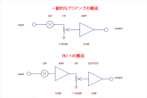

Steve Eddy said:It's never made any sense to me to have a gain stage ahead of an attenuator.
There is at least one manufactuarer that claims otherwise: http://www.ba-labo.com/balabo/f_page/fe_win-bc1.htm
A traditional control amplifier has been employing the pre attenuation method that the input signals are made to decline with attenuaters at the first stage of an amplifier, after that the signals are amplified. This method, however, degrades the sound quality, as low level signals once attenuated are buried into the thermal noises and fluctuations. No matter how excellent amplifier after that the signal made to decline once, the original signal quality can't be restored again. For example, the contents on a paper which were made by size reduction copy once can't be 100% restored by means of a copying machine with a size expanding copy, as detailed information have been lost at the first size reduction and the reproduced copy is felt rough outlined and isn't vivid on the expanded copy. BC-1 uses "Post Attenuation Method" to avoid these degradation. The input signals are amplified at the input stage of BC-1 before attenuation, then made to decline at the later stage of the amplifier to the necessary level to the output. It becomes possible at the next generation high end control amplifier, BC-1, of the dynamic range as well hardly to make it deteriorate and keeping the high purity as to. The high voltage power supply in BC-1 enables "Post Attenuation Method" without loosing dynamic range and low level linearity.
Terry,
You asked about using an atten between the sources/emmitters of a diff pair as again control mechanism.
We did it on our tube line stage of our RTP3 prototype preamp, for about three months.
Sounded great, but had problems that we couldn't solve so we went back to a conventional switched resistive attenuator.
Main problem was shifting DC offsets, which gave huge bangs through the system with a gain control change. You could trim it up but a week later it was banging again.
Second problem was that to get enough gain change, that R had to go from zero to 100k, then the fequency response was really screwed, as the stray capacitances gave far less atten at 100kHz and up - than at lower freqs.
The problems may have been much lower with a solid state gain block, but we tend to not use them...
Our hybrid mic pre does use this sytem, between the emitters of a MAT02 bipolar in diff, but the users are warned that gain changing during recording is not recommended...
Regards, Allen (Vacuum State)
