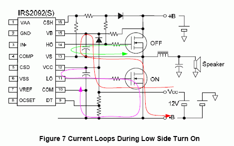

I got this tought after reading AN-1135 from IR. It is not specifically about decoupling, but within the explenation lies why decoupling is mandatory.
Oscillation is only an effect of with improper decoupling. The cause is something more important (and far more simple).
The main cause is the law of current eternity. "Current comes out+current that comes back must be =0". However small the current is, it must obey this law.
Decoupling cap give path for this returning current. Consider the cap is the "battery" that powers the IC. Every current that leaves the +terminal must be replaced by exactly the same ammount entering it's -terminal.
For positive output, the flows comes from this cap's +terminal, entering +supply of opamp, leaving the output node of the opamp, goes to the load, and if this load is grounded, it travels through ground track, then returning to the -terminal of the cap.
Why we need cannot only put elko? Because elko only works for lower frequencies (working below 100khz), for signal >100khz we need cap that can pass this HF, like ceramic or tantalum. Only with elko the opamp will oscillate at HF, because there is no return path (of whatever the opamp has deliver via it's output node) for HF signal (elko cannot provide path for HF, ceramic/tantalum can). The opamp won't care, from DC to its Mhz maximum working frequency there should be path for this returning current (of whatever it has deliver through it's output node) back to opamp's +and- supply rails. And if the return path from the load is coming from ground path, there should be cap (of all frequencies) from ground path to +and- supply rails of the opamp.
But this makes me more confused. If we follow this logic, then the "law" to "separate dirty ground and clean ground" is wrong.
Separating dirty ground (supply decoupling) from clean ground (signal gnd), cannot be done just like that, we must study the loop first.
If we blindly follow that law of "dirty" and "clean" grounds, it just make the path much longer (and more inductive with longer PCB track).

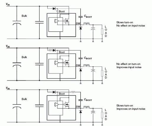

This diagram is about bootstrap, but maybe we can learn something about decoupling cap. There are 3 way to put R. The dioda makes 1 direction flow, the energy from the cap cannot flow back to the rail.
The first one is R to the opamp's supply pin. It helps for current flowing to the opamp, but don't help for rail current charging the cap.
The second one is R to both the opamp's supply pin and decoupling cap. It helps for rail powering the opamp, but don't help for cap powering the opamp
The third one is R only to decoupling cap. It helps for cap powering the opamp and rail charging the cap.
