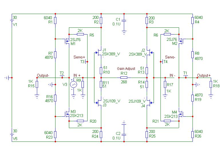

Well folks, you pretty much have it! This is a simplified version of the line amp that we used in the CTC preamp. Does anyone have a computer emulation of this circuit? I don't, for a number of reasons, but I know what it measures. It would be interesting if the emulation looked almost exactly like the measured output.
Hi John,
Computer simulations would only make sense if the Line Stage circuit is also shown with specific values and component types used. As such it would be interesting to know if you allow such to be shown here.
Furthermore, what kind of simulations would you like to see, for instance frequency plots of output and servo, voltages/currents/dissipation node/probe figures on the schematic, etc. ?
John,
The last stripped Line Stage circuit provided may be close to the original, but that I don't know. Apart from that the only resistor-values we know for sure, the 200 Ohm resistors at the top and bottom of the circuit.
Given your knowledge of the topology and your confirmation as such, it can be turned into something that works. What the other resistor-values are and how many more there may be, including the used JFETs/MosFets, is anyone's guess.
A simulation providing results which equal the real thing as such to me is only possible if a basic circuit with reasonable resistor-values and JFET/MosFet types exist. To my knowledge such is not the case.

john curl said:I am not interested in knowing if this circuit works, (I know that already), but how it changes with different values of resistors. There might be an 'optimum' operating point that would be implied by the computer printout that I may have passed over. You never know.
John I think that simulations will not be very useful, and doesn’t mean anything serious in audio, just here the Vds/Id function of Vgs, with SK216/SJ76 spice models… Let us know if you are still interested in some sims.

Actually, the curves for the j76 do not look OK. They should be more 'triode-like'.
As far as exact values are concerned, I am not giving them out. Not because they are so special, but because I specified, up front, that I was not going to publish the specific schematic of this line amp, as long as I am still producing them. The simplified schematics presented are a good base to discuss the circuit, and even for someone to make something that should work well on an individual basis.

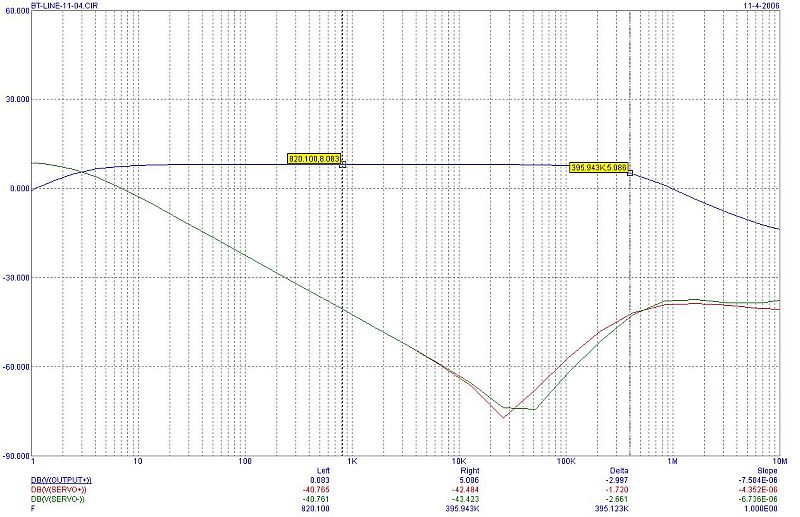

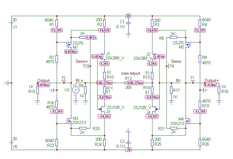

Hello all,
Presenting an individual schematic and simulation plots in following posts.
The Line Stage schematic shows voltages on various points in the schematic. DC Servo is a value-adjusted version of Justcallmedad (thanks btw). Frequency plots are from the Output+ and DC Servo +/-.
Of course your comments/suggestions are more than welcome for further improvement.

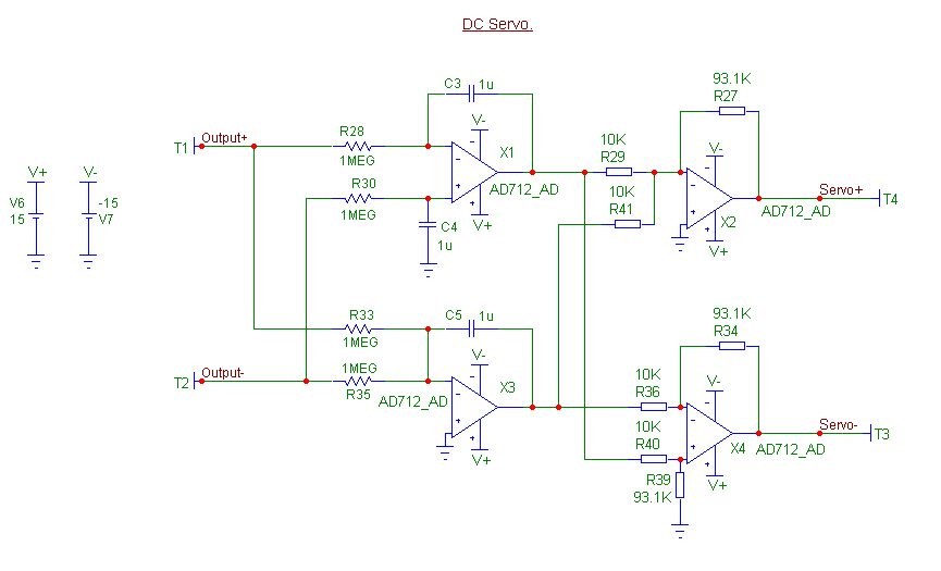

Symmetry?
The pictures of the BT inwards I saw show more caps in the servo.
Why not just 2 servos separately for each branch?
I get confused analysing your servo! At least there should be symmetry in your schematic, which is not there. Rising response of servo beyond 30kHz not good!
courage said:Here's the DC Servo schematic
