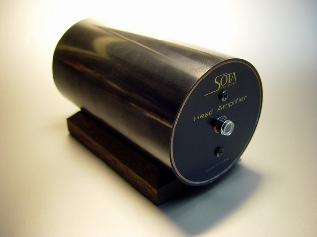

Its not because the well known designer posted in here that I write my positive impressions with this picture, its just that I’m very pleased to see a wiring topology which doesn’t care to please the eyes of a punctual house cleaner, and which disregards rulers and T-squares ;-))
I especially liked this curved silver input connectors to selector wiring.
I would be very pleased though to learn if it is a 1mm one-ply pure silver wire that is used, as I presumed.

Just look at the way it is wired... forget about circuit design. It may be a good circuit, I wouldn't care to find out, but the wiring is all about appealing to the "rich and confused". This is about reaping "old money". "New money" is seldom that foolish.
poobah said:
... the wiring is all about ...
Poobah, how do you *know* what you assert? Maybe, just a little smidgen maybe, the wiring is not *all about* (= about nothing else whatever) what you say it's about? The wire, for instance, looks silver, which is an excellent sonic choice in my books, but maybe not yours, which is to say it might smidgenly appeal to not only looks? Just a wee bit maybe?
What I know (and many other's) is this,
1. The wiring has large loop areas... this is bad... any magnetic field wandering along just found a nice playpen.
2. The "solid billet aluminum" chassis will do nearly nothing to prevent the intrusion of magnetic fields.
3. The amount of voltage induced in these loops is probably insignificant... why then is the resistance of copper wire significant... and please don't bring up "sonic" sheep dip.
4. The style of wiring leaves much to be desired for another less obvious reason. Who would want to repair this? Of course it's made out of the finest cryogenically abused devices that will NEVER fail. One benchmark of quality products is serviceability.
This is frustrating when you consider that if they chose to use copper wire; maybe they wouldn't have been so inspired to scrimp on every inch of it.
This is as bad as St*** Nug***'s "Holophonic" $1500 power cords.... puleeeze!

That is a really well done piece of equipment! If you take notice of the marking on the volume dials it would seem as though the unit is actually resting on it's top in the photo and the bottom panel is the one that is removable so the enclosure looks seamless when it's upright.
For the price I would expect to see the pots and switches placed closer to the inputs with shafts going to the front panel, but hey I don't plan on buying one either 🙂 Still, it's quite pleasing to the eye and I'm sure to the ear as well.
Well, it seems like the switches and pots are mounted directly to what is left out of that aluminum block. Maybe there is a reason for that. If shafts to be used, they might affect the sound the same way as the famous $500 wooden knob "improves" the sound of the pot.
Besides, placing the switch directly at the inputs, saves only few feet of the silver wire, signal still needs to be routed to the boards and to the pots, and placing the pots directly on the front panel was certainly not coincidential.
I checked the inside of Placette passive preamp. Even although it is passive unit, the box is well damped and a lot of effort went into decoupling a tiny board with resistors and relays from the chassis (with sorbothane pads).
Anybody noticed how RCAs are mounted?
