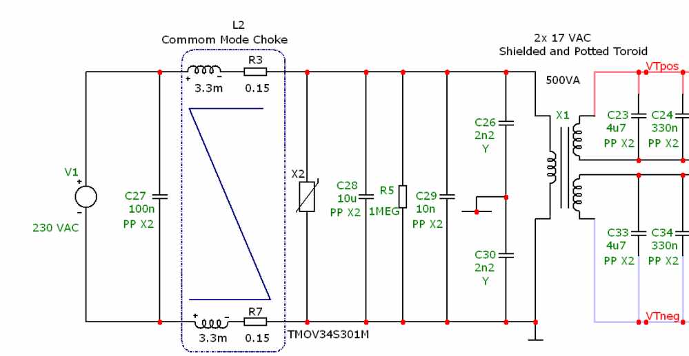

John,
I do agree on having some form of filter for the AC mains garbage. Attached is part of a power amp power supply I did for a guy. He did NOT want to have any fuses although I strongly recommended it to him. He do not use any fuses at all except for the large one in the central.
I added a transorb, too.
He is very happy about the shielded and potted toroid.
Sigurd
Sigurd
