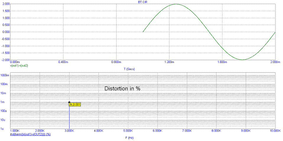

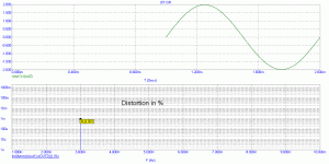

you can find the simulation result here
Harmonics Sim

chascode said:
PMA, could you list the post with the schematic that you and John agreed would be the best approach. With all the OT and other diversions I'm afraid I lost it in the shuffle.
Thanks, Chuck Hansen
Yes, this one is from 2006. There was also something this year, in the times when we simulated the complementary-differential JFET input stages.
Why??
I have shown it here at least 3 times. I am not supposed to repeat it every Tuesday. The difference is that in 2006 I have not simulated it for balanced input/balanced output (or maybe I did, I do not remember), and few resistors had different values. Few resistors, nothing special.
