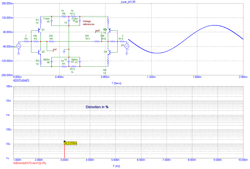

Here we go:
(distortion 3rd H is 0.000015%)

PMA, I thank you very much, but I think that we have hit the end of the line. I will not put forth anything directly that is less than 30 years old on this website, but it has been fun to see these models of topology idealized. I personally don't see the point in giving any more real information to this general group of people. Feel free to contact me directly or through this thread, but I have run out of steam. Thanks again for your great modeling, I wish I could share more sophisticated topologies here, but I just can't afford to.

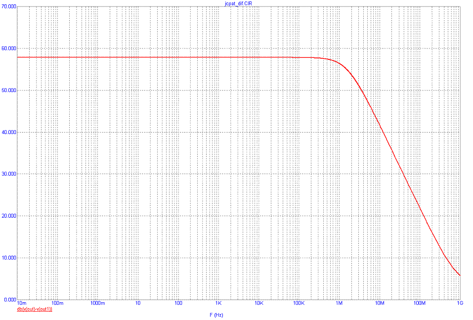

Hi John,
The end of the line? I don't think so. The biggest challenge is how to realize the correct bias currents.
@Pavel
In the virtual world of MC, the voltage sources V5----V8 are easily implemented. But would you do that in real life?
How to address issues like noise, internal resistance, and (maybe even more important) temperature compensation.

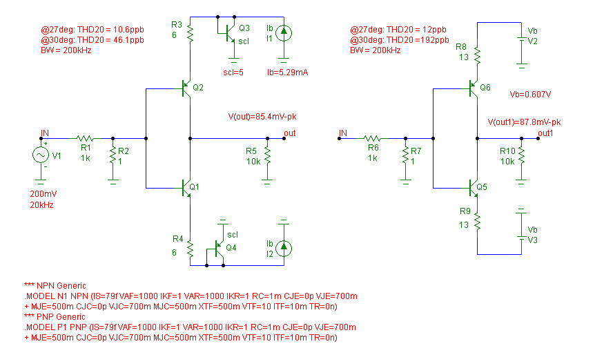

Hi Pavel.
Back to technical input. As promised, I've fiddled a bit with the bias circuit. It is a first attempt, so it's not perfect, just an idea.
From the figure below, we can see that biasing with a constant voltage is very critical and that temperature has a profound effect on distortion (and gain!).
Biasing with scaled up (5X) trannies and currents sources makes the circuit far less temperature dependent, at least according to MicroCap.
Is it practical? I don't care, did it just for fun.
Edmond.

PMA said:
There was a good reason why it was biased through resistors + big caps. There is a way how to find proper constant voltage biasing, however.
Hi Pavel,
A constant bias current is far from optimal. As you know, of course, for minimal distortion one should set RE = 0.5 * VT / Ie, where VT is the thermal voltage at room temperature (~26mV) and RE is the sum of the internal and external emitter resistance.
So, you need a current source which varies linear with the abs. temperature.
Edmond.
