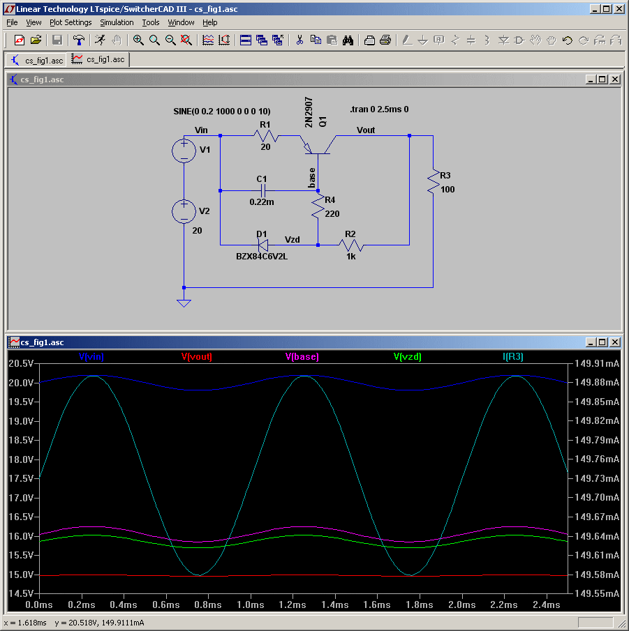

Richard, what I am most concerned with is the 1K resistor. Looking more carefully at your complete schematic, I see that you have only a 2V differential across the 1K resistor and this implies that all the current from the resistor goes into the transistor to supply the base current. Is the 3V device even turned on? Anyway, why not put the 1K resistor to ground. Wouldn't that work OK?
As far as design philosophy is concerned, I like to think about new ways of making circuits. Sometimes, I see a new way of looking at a circuit on this website. I find that interesting. However, why don't I like normal IC regulators that much? Well, they are noisy, have bad transient response, and fall apart at high frequencies. I prefer, myself, to use an active IC regulator in series with a simple high speed fet cap follower. This gives me the DC stability of the feedback regulator with the high speed response and low noise of the fet follower. That is my approach. I know that some circuits may be less critical of power supply effects, but I do know that complementary cascode circuits are VERY sensitive to power supplies. That I why I put so much effort into power supplies.
Here we have a quick simulation of fig1. The current source provides voltage gain for the input ripple when loaded with 100 Ohm.
I used components only that are in the distributed library of LTspice.
There was no 3V zener so I used a 6V one, I doubled the 10R.
The Input voltage is 20V with 1% ripple, or 200 mV. The output AC voltage is 1.8V. This results in a voltage gain of 9. The only node that's pure is the base.
Removing the capacitor (just set it to 1p ) makes it much better, but still not great. The Z diode + 1K is too easy a path for the noise. John's FET current source is definitely required.

Regarding noise:
Has anybody here measured the 1/f noise corner frequencies of power MOSFETs? I fear they might come as bad surprise. JFETs should be OK.
BTW I find it kind of unfair to say that current sources amplify their noise. If we do our best to construct a thing that behaves like a large resistor, we should be ready to accept that it's voltage noise is like a large resistor...
I speculate for symmetry reasons that the same holds true for active voltage sources and current noise?
regards, Gerhard

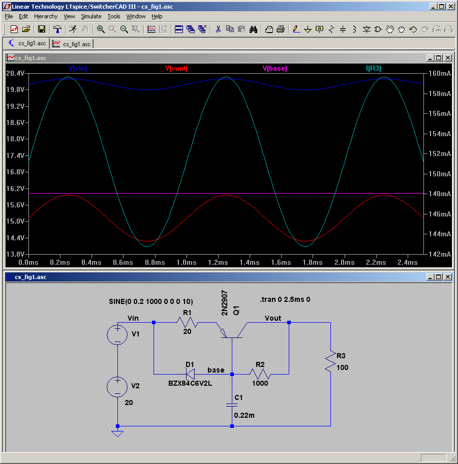

Now it's much better. The ripple gain is gone. Altough we have a 6.2V Zener, the voltage across the diode is only 4V. That means that the 1K resistor cannot deliver the current that is required.
Now if we insert a >6 mA FET CCS instead of the 1K we probably have something we can use.
BTW running Zeners with less than enough current makes them generate even more noise.

Gerhard, you use a 100R shunt resistor? With a current about 0.25A (6.2Vz-0.7Vbe/20R).
Caesar: Divide et impera (in English Divide and conquer IIRC)
For the moment I'm only interested in getting the current source right. The current that really flows is only 149 mA (light blue, right scale) because the Zener is current starved at 4V.
It's fun to play with the load resistor. In the first circuit, 1K makes the ripple clip. Or try 10 Ohm. Spend a virtual heat sink for the tiny 2N2907 🙂
