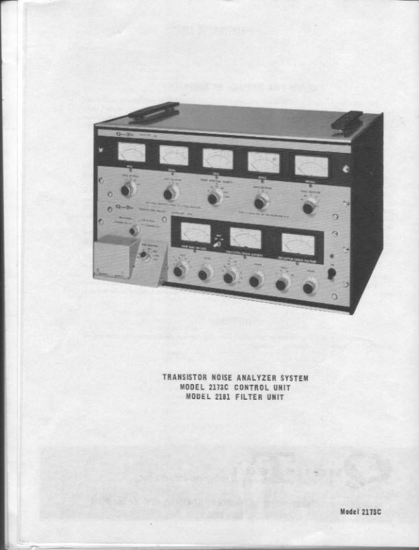

SY said:At John's request, the Right Way to get noise measurements.
You could recreate one with a little work and a good sound card. No unobtainium inside, just a lot of old bakelite PC boards (I have a set of the schematics). Clever bias control allows setting operating point and a calibration of gain right to the input. The digital ones are no fun though.
No need to get into that discussion or we'll be back to 40 years ago....

scott wurcer said:Notice date on reference below 1977, but I can't find the products now. Of course there are no discreets or never were any and I think only one flavor of MOSFET was super quiet.
Not easy to make a QuanTech equivalent, but possible. A friend of mine has done it in the Bay Area. SY, I could introduce him to you. He knows as much as I do on the subject, BUT his expertise is ultra low 1/f noise. We use essentially the same parts.
Better to use a FFT based analyzer as the readout, because it is faster.
For the record, I still work consistently at 2.5 times LESS noise than the AD797, so Scott has a lot of catching up to do. All done thanks to QuanTech.
I'm working at .25nV where have you been? There's no commercial products there just lab stuff. I asked a while back,"How would you make a useful .1nV amplifier". I still don't have an answer.
