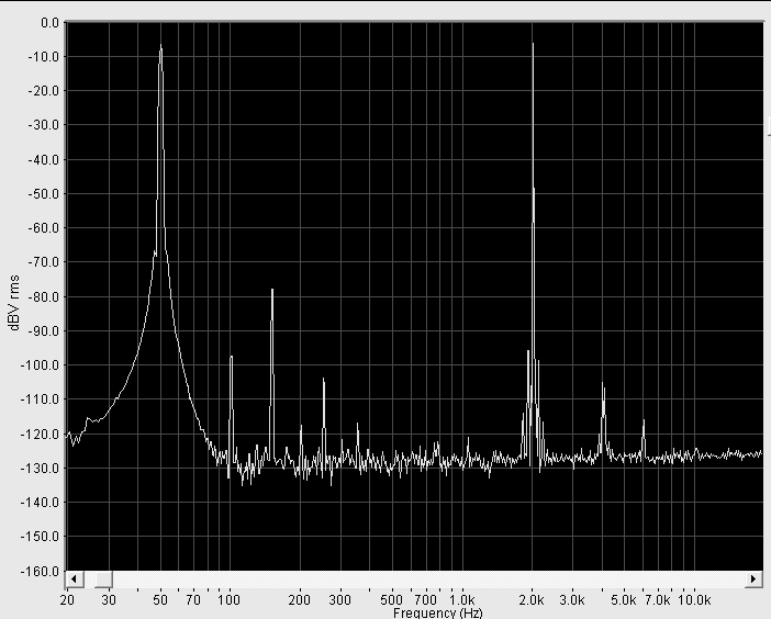

I'll risk posting another NTL1 transformer measurement. It is IMD 50Hz + 2 kHz at 1400 mV RMS, 50 Ohm source, 10K load - the same spec as on dimitri's pictures.
Alex

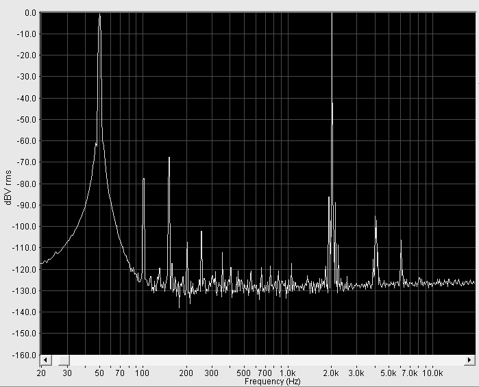

john curl said:
Would you try it with a 2K source? That is the minimum Z that I can do today.
Here it is - for 2K2 source impedance. 1.4V RMS output (about 1.7 RMS on the input of the transformer and 2.05V RMS before 2K2 source resistor.
Alex
P.S. - increased noise level is due to an additional amplifier I had to connect to boost the signal.

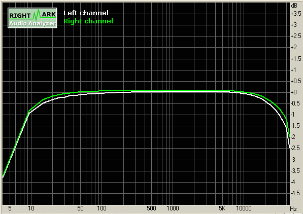

Some more pictures for 2K2 source and 10K load, now I had to resort to RMAA to get the frequency response quickly, without firing up HP3563A 🙂 . Right channel is a loop bypassing the transformer, left channel - through the transformer. HF rolloff is due to the amp used, LF rolloff is mostly due to the soundcard. Levels are matched by an additional attenuator for the R CH.
Alex
