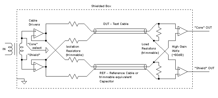

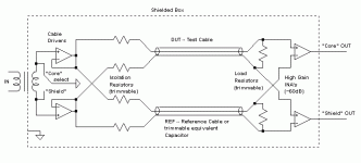

A while ago I've tried to find sound/distortion issues of cables with this setup, which IMO qualifies as a good measurement strategy because it mimizes many issues with seperated or sequential tests and it really tries to test the cables "as such", with the best possible isolation from secondary system effects (shield currents, RFI issues etc). Unfortunately I didn't find any cable effects in spite of the rather high resolution (which I probably could improve some 30dB with what I know now) and I quickly stopped testing, dissapointed from the "non-event" (which btw was not the first effort of this kind, but the earlier two had serious issues -- both systematical errors and noise problems, mainly).
Bottom line: Under that specific conditions I could not detect a differing behaviour between a small variety of cables (1m lenghts) and their lumped RC equivalents, resp. Which doesn't prove anything, I'm well aware of that. And that's why I stopped digging further.
