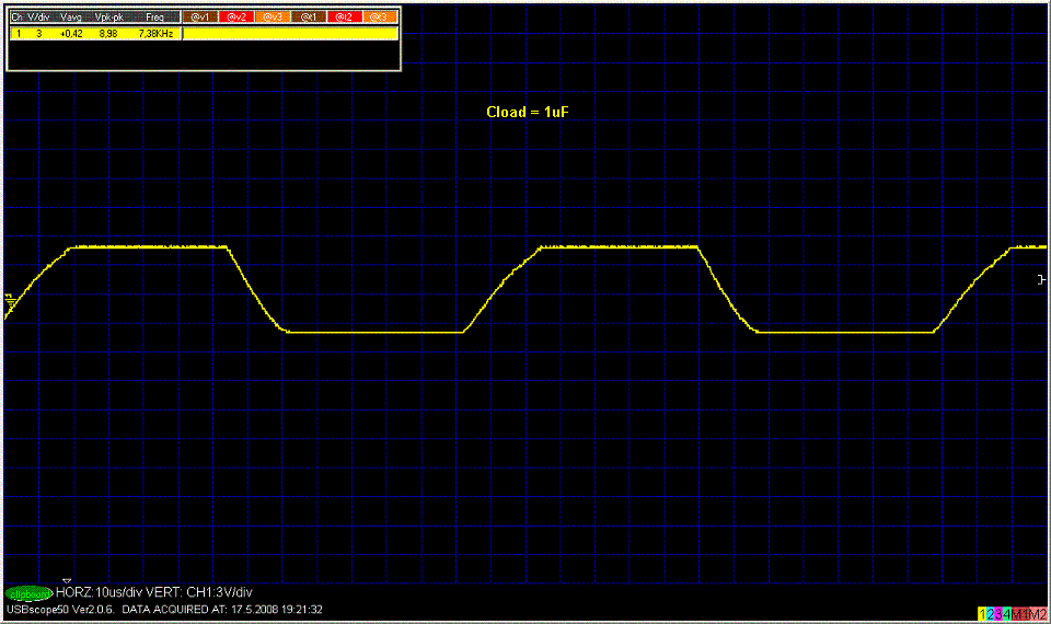

We tested different output impedances for several years, and the result of listening tests was that something like 5 ohms was a winner. We tried output impedance same as cable characteristic impedance and we tried matched cable as well. Finally, it was few ohms as a winner. Output stage of the preamp is robust, see square 7kHz into 1uF, the output impedance is 3 ohm in this case.
