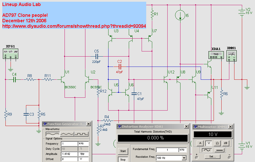

Comment: AD797 comp cap C2
scott wurcer said:
It's Walt's super regulator from the AA article except I added the distortion neutralizing capacitor to the 797. I pointed out to Walt that this cap cancels the output impedance of the amplifier but it never got into the article. 1e-6 Ohm from DC to 100kHz.
aparatusonitus said:
Yes, it's the capacitor from output to current mirror input, see figure 31 (capacitor Cn) and figure 44, table 6 (capacitor C2).
See my attachment.
It is my discrete AD797 Clone from 2006.
( http://www.diyaudio.com/forums/showthread.php?threadid=92094 )
Supply is +/- 15 VDC.
Image shows 10Vrms output = 14.14 Volt peak!
into 2200 Ohms at +20 dB gain. (x10, set by 24k/2.4k)
I do not remember I did try some different values (47pF) for C2 in my simulations. The distortion is so vanishing low, that eventual improvement by tweaking compensation caps are hard to measure.
At least with my Simulation software ( EWB MultiSim9 )

Hope you do not mind, john curl, that I posted my AD797 Clone attachment.
At least it is a discrete amplifier schematic, using virtual transistors, BC550C etc..
Regards 🙂 lineup, Sweden May 2008
