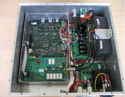

John,
there is something that surprises me. I am talking nonsense, and I do use thick aluminium with double box shielding (see image). The other uses woodwork with aluminium foil, and he is on the right track, as you used to say.
