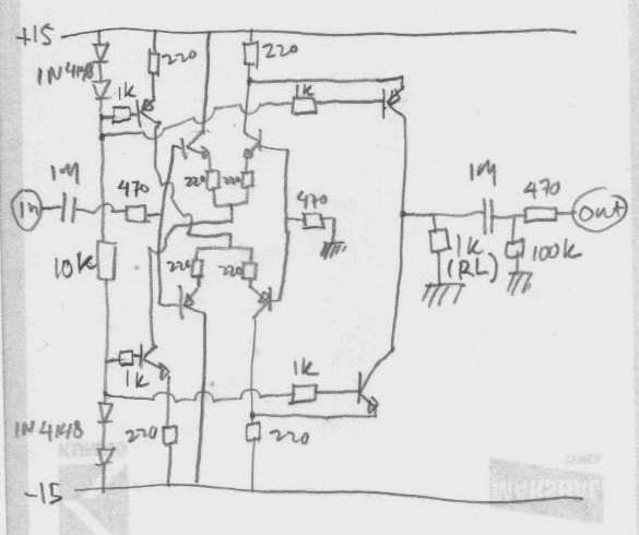

Is this results in folded cascode open loop transconductance preamp with RL=1k (bipolars)?

It doesn't bother me any. I have built a few circuits along these lines with variable results, but I attribute that to my being in the learning curve, not to a flaw in the concept. When it works, it works very well indeed.
Higher Zout amps tend to work well with speakers that don't need a lot of damping. Otherwise you need to think in terms of feedback loops that include the driver itself. That adds a layer of complexity that most people don't want to get into because you've got to modify the driver or do something suitably hairy to get the feedback signal. Lotsa trouble for little or no gain.

Again, another dummy question. Is the tranconductance amp "tends" to sound better, because no crossover distortion in the output node, since no emitors in the output node (current comes from collectors)?
An example is Musical Fidelity. Many people said it is sounds good, and it usually uses collector/current output (=tranconductance amp)
