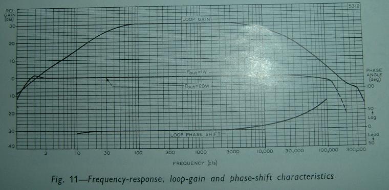

john curl said:Please SY, you only confuse the situation. Look in 'Electronic and Radio Engineering' By F. Terman (1955) and note that EQUAL weight is given to motorboating as to high frequency stability considerations. Just because YOU know how to avoid it, does not mean that others in that time period had the knowledge and tools at their disposal. Please remember we are talking about a triode amp designed by Sid Smith in the 1950's, NOT one of your latest designs. In fact, I don't see why we could not extend the high frequency performance as well with a paralleled high freq only transformer, in parallel with a good audio transformer. Then YOU TOO could add more negative feedback, with all its 'advantages'. 😀
Back in the 50's the audio engineering fraternity did indeed have the knowledge and tools at their disposal to build valve amplifiers with relatively high levels of global negative feedback.
I can scan for you a number of articles from the era detailing designs with levels of feedback well above 20dB and bandwidth’s over 100kHz - the principal restriction to the amount of GNFB is almost always the HF response of the transformer – not motorboating, which is easily addressed with attention to PSR and supply rail decoupling.
The low frequency response of the transformer can be an issue in some circumstances (I have a rather high global NFB Mullard design in which the open loop LF response is deliberately tailored to increase the low frequency phase margin, but this type of low frequency stability concern is a distinctly different one to motorboating, which is oscillation incurred by feedback via a modulated powersupply.

Some of the Mullard power amplifier designs from the late 50's fit the criterion and they all use output coupling transformers.
Preamplifiers (especially RIAA) used gobs of GNFB.
Details of Mullard’s 1959 20 W power amplifier, from chapter 5 of Circuits For Audio Amplifiers:
Closed loop bandwidth 100kHz
GNFB (loop gain) – 30dB at 100Hz, rolled off to 24dB at 20kHz
Graph attached below
Note that this open loop response corresponds to a unity loop gain of less than 200kHz, which (contrary to what some may say) is absolutely blown out of the water by moden solid state amplifiers, with unity loop gain frequencies typically between 1 and 2 MHz. As far as bandwidth is concerned, even with a modern torodial coupling transformer, a valve amplifier still won't match even a mundane solidstate design using low fT transistors in the output stage.
