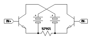

For those who don't find a cyclotron schematic, see attachment.GRollins said:Not a lot of people realize this. I've found that the schematic of a Circlotron can sometimes help, as it makes the signal-through-the power-supply-cap link somewhat more explicit.
I find this the most "natural" way to construct a bridge / push-pull amplifier, the most basic differential follower.
It clearly shows the series current path through the supplies. Imperfections there wouldn't hurt if there were no parasitic effects of a fluctuating supply voltage for the current gain devices.
The circuit I linked to in a previous post in this thread shows the same series path for a conventional amp topology.
EDIT: I will never learn that it's called Circlotron, not Cyclotron ;-/
- Klaus

KSTR said:The circuit I linked to in a previous post in this thread shows the same series path for a conventional amp topology.
Perhaps this will make it a little more clear that pretty much all of the current delivered to the load comes from the power supply capacitors.
