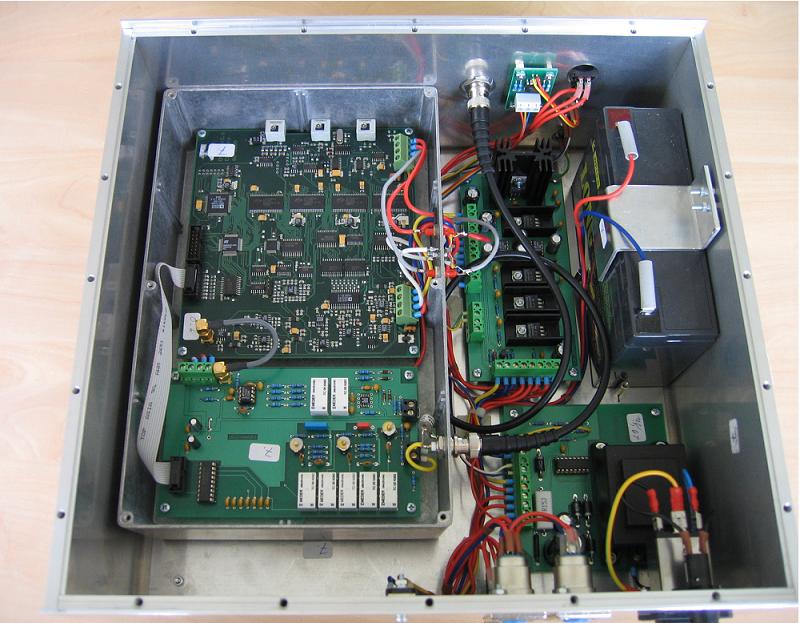

I tried several times here to explain principle of eddy currents shielding.
John, look at this picture to see input connector (BNC).
For Cu, frequencies and skin depth:
50 Hz 1 kHz 10 kHz
9,3 mm 2,1 mm 0,66 mm
Skin depth would be a thickness of material when mag. field component is decreased to 37% of original level.
50 Hz 1 kHz 10 kHz
Your shielding looks thick enough to me. My aluminum shielding is about 10mm thick on the front, top and sides. The back is only 6.5mm. Am I in trouble?
Mine is 8mm on all sides. I need Al because Fe, mumetal etc. saturate, as my instruments work in the vicinity of 40kA/50Hz test currents. Saturated shield makes troubles.
I am sure you are not in trouble. For 60Hz AL, the skin depth is 10.9mm. Your 6.5mm would decrease 60Hz to some 50% of original intensity. Faster mag. fields will be decreased much more.
