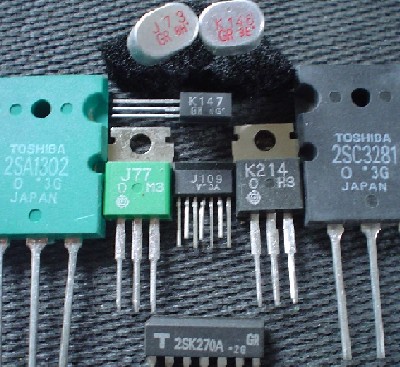

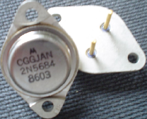

As a reference, these original 300W/50Amp parts from the JC3/ML2 era do +$30 each overhere.
Same goes for similar somewhat less goodlooking devices, such as STC J2N5684/86.
Talking pennies and dimes while parts are still relatively easy to obtain is time wasted, imo.
